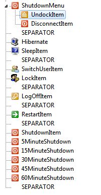

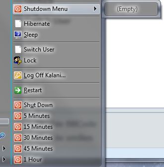

hey, i dragged all of the items from the default "Shutdown" menu, and made them all buttons of their own, but when i dragged them out, even after I selected an Icon, the icon didnt work
I used standard shell32 & imageres dll icons
All of the items did not work, including:
Log Off
Switch User
Hibernate
Sleep
Lock
Restart
I had to delete the ones that were also found in the default right window with icons, which were Log Off, maybe thats all
the bottom of the right column had:
Switch User
Hibernate
Sleep
Lock
Restart
and I could browse to Icons for all of them but Hibernate & Switch User.. no matter what Icons I chose for those, they didnt show up, even after I restarted..
below are the two pictures, and how they differ..
and a second problem is that I cant get Undock & Disconnect to show up at all, they bot just are completely absent from the menu, even if I drag the item from the right column to the left column
thanks for any help

1. Exit Classic Start Menu. Make sure hidden/system files are set to show. Open %localappdata% and delete IconCache.db. Restart CSM.
2. Undock item shows only for portable computers when they are docked to a Dock. Disconnect shows only over Remote Desktop.

ok, thanks i see..
and i did that, then it still had the problem, then I deleted those two items again, and then re-added them from the right menu, and selected the icons and it worked.. so i think you were right on about icon.db, maybe it just needed to be re-pointed to the icon or something.. it works fine now, thanks
