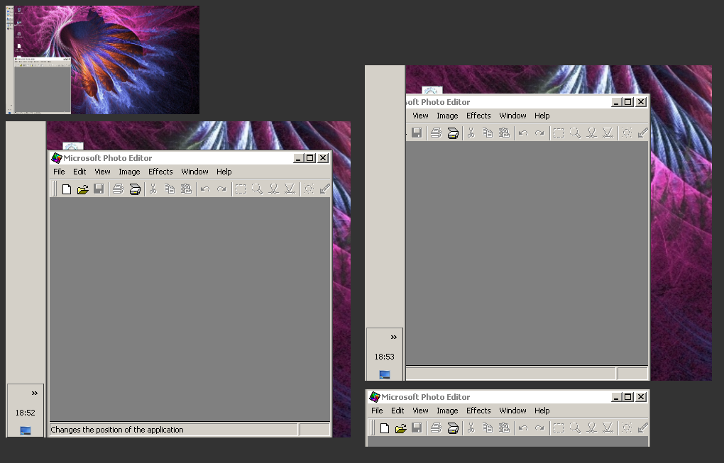

I've not uploaded to this forum before, so if no screen shot appears, well, I'll try again I guess...
The screen shot is a composite.
10 o'clock: My desktop with Microsoft Photo Editor open and abutted to the vertical Taskbar.
8 o'clock: Closeup of the screen shown at 10 o'clock.
3 o'clock: After I close Microsoft Photo Editor and reopen it, this shows where it is positioned.
5 o'clock: This is a copy of the Microsoft Photo Editor Titlebar, which demonstrates that it reopened behind the vertical Taskbar -- this is a problem.

I will give it a try. I just wanted to pop in here to tell you that I found a way to get a rebellious application window back on-screen.
[HKEY_CURRENT_USER\Software\Microsoft\Photo Editor\3.0\Microsoft Photo Editor]
"Show"="1"
"InitialPosition"=" 0, 282, 736, 691, "
Note that "0" in the upper left corner is behind the vertical Taskbar, so the width of the Taskbar is NOT being taken into account.
PostPosted: Mon Apr 18, 2016 7:01 pm
Joined: Sun Apr 17, 2016 10:48 am
Posts: 17
I de-installed Classic Start Menu. The problem did not go away. Something has damaged my Win7 system.
Each time the Microsoft Photo Edit application is closed and it's position is saved in the registry, it moves left by the width of the Taskbar.
[HKEY_CURRENT_USER\Software\Microsoft\Photo Editor\3.0\Microsoft Photo Editor] InitialPosition: 100, 202, 300, 611,
launch application
close application
[HKEY_CURRENT_USER\Software\Microsoft\Photo Editor\3.0\Microsoft Photo Editor] InitialPosition: 42, 202, 242, 611,
launch application
close application
[HKEY_CURRENT_USER\Software\Microsoft\Photo Editor\3.0\Microsoft Photo Editor] InitialPosition: -16, 202, 184, 611,
launch application (no part of the app window is visible)
close application
[HKEY_CURRENT_USER\Software\Microsoft\Photo Editor\3.0\Microsoft Photo Editor] InitialPosition: 32709, 202, 32909, 611,
At this point, the application is so far off-screen that it can't be corrected in the usual way -- the registry value above has to be nuked.
Obviously, the x-coordinate value is overflowing. This is really bad news for me.

PostPosted: Mon Apr 18, 2016 7:18 pm
This is a common bug in software. It reads the position relative to the work area (the desktop minus the taskbar), but restores it relative to the screen.
BTW, the Wikipedia entry for the software mentions specifically a bug with the initial position: https://en.wikipedia.org/wiki/Microsoft_Photo_Editor

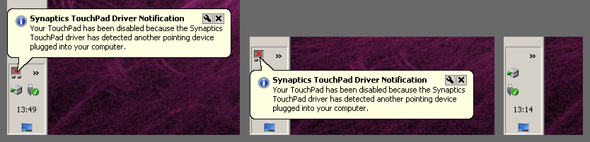

PostPosted: Tue Apr 19, 2016 10:34 am
Posts: 17
We're making progress!
The attachment is a triptych from the Notification Church.
For this test, I turned touchpad notifications back on.
See what happens !!!
The missing icons on the right (after touchpad notification) are really missing. There are no tooltips on mouseover for the missing icons (sometimes there is, even though the icons are missing).
This does not happen when Classic Shell is not installed. And it does not happen when Classic Shell is installed but touchpad notification is off. It only happens when Classic Shell is installed and touchpad notifications are not "hidden".
BTW, I repeated the successful test from 2 messages ago 10 more times and got success all 10 times. Then I turned touchpad notifications back on and got what you see in the attachment on the very next boot.
I'm pretty sure this is a timing issue. What say you?
Given that this apparently is not an issue of vertical-vs-horizontal Taskbar, what would you like me to try next?

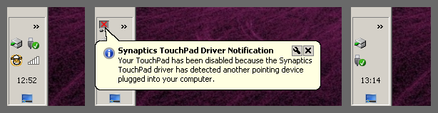

PostPosted: Tue Apr 19, 2016 11:14 am
Posts: 17
I will try the Taskbar horizontal at the bottom -- I don't think the problem will be evident, but I'll try it. In the mean time, I want to show you the full sequence during Windows initialization. Note how the touchpad notification starts above, then jumps down as the Notification Area becomes populated.
PostPosted: Tue Apr 19, 2016 11:53 am
Posts: 17
Hahahahahahahahahaha.... The Taskbar is still on the left. ...I can't get it to screw up at all, now. Not much point going on if the symptoms will not harden enough to be repeatable. Nonetheless, I will now move the Taskbar to the bottom and try several boots.

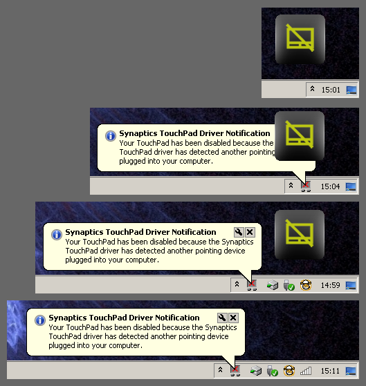

PostPosted: Tue Apr 19, 2016 12:25 pm
Posts: 17
See the attachment...
When the Taskbar is at the bottom, the touchpad notification moves as the Notification Area becomes populated, however, at no time does the notification obscure the Notification Area. Does that make a difference? ...I think so, but considering how in the dark I am, I think the phase of the moon probably also makes a difference. 8^)
I don't have development tools and I can't get the symptoms to go hard and be repeatable. I'm out of ideas.
