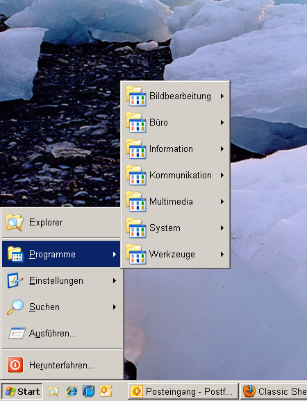

Another screenshot - icon size should be 32 px, but the icon size of the main menu is 24 px. The icon size of the sub-menu's is correct (32 px).
PostPosted: Wed Mar 20, 2013 11:01 am
The icons in the main menu in your screenshot are not 24x24. The Run icon is at least 26 pixels wide. Place the same program in both menus and compare the two icons.

I found the problem ...
E.g. the standard icon for the programs entry in the main menu is "shell32.dll,326". If you use a 32x32 icon, you get an icon with 23x23 - the missing 9 pixel are just transparent pixel (same with the other sizes like 16x16). The icon which I use for the folders in the sub-menu's is a real 32x32 pixel icon (or 16x16).
Therefore it's not a bug of Classic Shell, but a 'bug' of Microsoft's icons.
