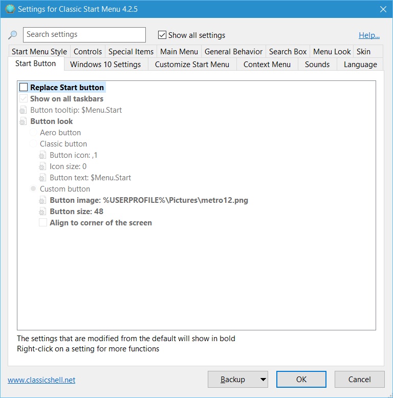

Running with the options in my screenshot below produces no scrolling problems in Firefox. However, when I check 'Replace Start button' I get choppy scrolling under certain circumstances. I can choose any button look to get the choppiness. I also notice that the Start Menu icon is smaller when the 'Replace Start button' option is unchecked than the buttons with the other options.
