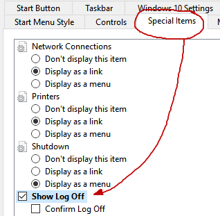

Hi markfilipak
The setting is in the dimension of imagination. :)
Works for me.
If it's a classic style menu skin, you will have to enable the extra setting "Show Log Off" in "Special Items tab"
Behold, the button will now emerge from the other dimension.
If it's a 7 style skin, that setting does not show, but still works.
Both styles also have an additional "Confirm Log Off" setting.
