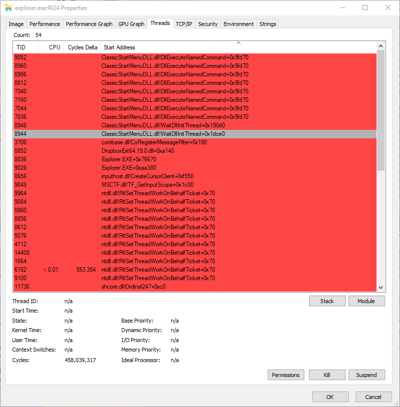

Add me to the list. I have been trying to find out what has been causing my explorer to hang. I thought it was Directory Opus and worked with them to discover they were not the issue. When I run sysinternals process explorer I found out it was Classic Shell.
The first thing I do when I start a new install is use ninite to install some apps, and ALWAYS use classic shell. I am seeing this exact issue on Win10 1703 and 1709 and Server 2016.
Please, I cannot live with the Standard windows menu and I purchased Start10 and it isn't even close!
Here is a screenshot:
