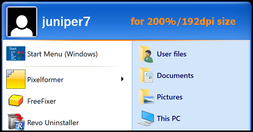

XP Blue 200% size [classic 1/2 style]
This is a test XP skin specifically for a 4k display monitor.
Problem is, I don't have a 4k monitor to see if it actually works correctly! :lol:
I surmise if 1920 x 1080 100%/96DPI is normal HD,
then double those figures 3,840 x 2,160 200%/192 would be 4k territory.
So what I did was enlarge every image twice as much (example-one pixel line becomes a two-pixel thick line).
So I think 200% size should be correct for 4k.
I tried this skin on my 1920 x 1080 100%/96DPI monitor with the override settings in Classic/Open Shell
set to 192DPI with small icons set to 32 and large icons set to 64.
Of course, the menu ran out of display room and chopped out items on the second column.
It might work as long as the 4k monitor runs at 192DPI.
I started out making a 400% size menu as well(for professional 4k)
but gave up on that because the user picture can't go any larger than 128 x 128 pixels size,
and the maximum image size for the magnifier at the search box is only 20 x 20 pixels. Way too small!

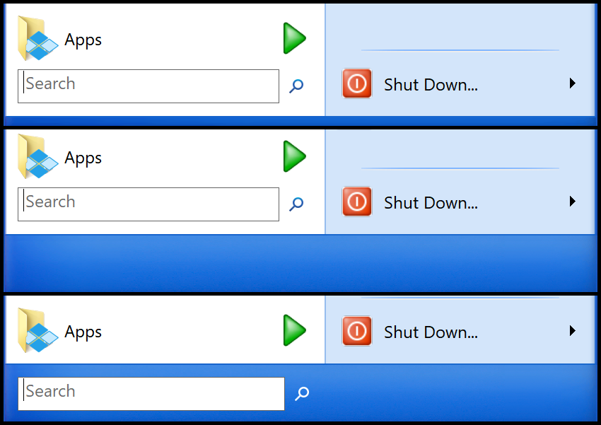

I did put an option to have the large blue bottom bar,
but no option for fake logoff/shutdown icons and text.
There is an option for the search box on the bottom bar though.

EDIT:
Made a few minor changes to be a little closer to XP looks:
Thicker invisible separator paddings
Smaller user name
User picture positioned more left
Darkened user picture shadow
Correct lighter blue text color on 2nd column
Option for old magnifier for search box (not enough room for its shadow. It's maxed 20x20 and still looks small)
I left the main menu paddings the same (not accurate). If someone requests original paddings x2, I will change and call skin revision B
and update the display pictures.
