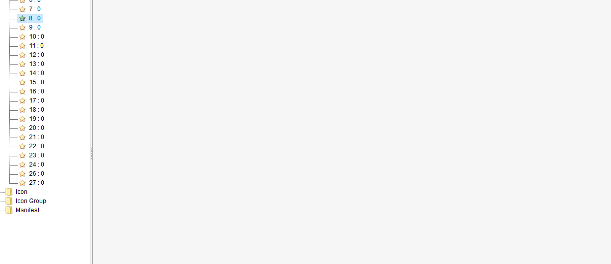

I think I might need some pointers xD I tried to edit a bitmap and the result was... a total failure xD Here's what I tried to do with bitmap 8, what RH showed when I replaced it, and then my resulting skin xD When I replaced it in RH, was I supposed to cut out the white part in the top corner or just in the middle? And I did export it as a 32 bit BMP. Apparently I wasn't listening about the merged RGBAlpha thing, but I don't know which bitmap to edit, if not more than one. Ugh, this is gonna be a long day... But I'm not giving up yet. I WILL make this skin full glass or my name's not Smitty-werben-jangerman-jenson! And it's not. Is making skins supposed to be difficult? No offense but it seems like it...
Yeah...I've had that happen when messing with padding, but if literally the only thing you changed was bitmap 8, then IDeK...
...what are you using to modify the skin? That doesn't look like Resource Hacker to me...

The image editor is GIMP, but I'm using Resource Hacker to replace the files.

OK AKA Smitty-werben-jangerman-jenson.
I've been known for doing a lot of head scratching, as we are all in the same boat.
It can be a real pain in the whatever. :lol:
Because it is very exacting, a wrong change will make the default white skin turn on.

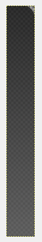

Looking at the image above, probably the bigest concern is, the size has changed.
I used Pixelformer.
I made the bitmap 1 all same grey. (the base color, with alpha transparecy level)
I made the bitmap 2 all same red gradient. (the red mask, that uses the system glass color)
Found out after doing the same to the search, and jump bitmaps, they all look the same.
I did not need to modify the other bitmaps 8,9,13,14. Just change text to reuse bitmap 1 and 2.
Tell you what, I can only torture a person for so long, before helping out.
I'll put the modded two bitmaps in a zip for you to replace in the skin file.

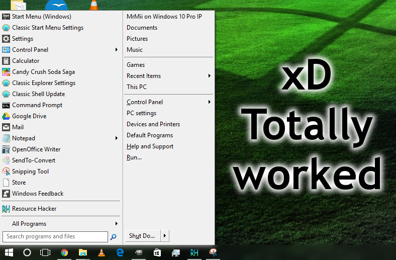

I implemented the bitmaps and script changes, and to my surprise, it worked xD Thanks a million! I also changed the main menu text from black to white. However, most fonts don't work with the skins it seems, like Super Mario 256 Bold, but that was just to test it. :D
When referring to your modded bitmap 1, does the black corner define alpha? Because I saw no alpha layer in my editor. Just curious.
And this is just greed talking, but does increasing or decreasing blur (in this case, increasing) have to do with bitmaps or the script? And uh, is there a way to add an open animation that isn't a fade in? Like a slide (or however you describe it) similar to 10's integrated Start? I'm only asking because the classic and classic w/ two columns styles have the ability for a fade in. I think I'm being just a tad bit greedy here... I apologize... :geek: If it can't be done, I can go without it.

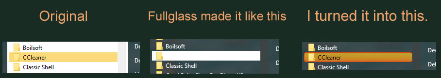

OK, I just realized after a windows update, that the inner "new program highlight" is white wonky,
as it was not designed for full glass background.
Not everybody likes the orange color.
It's not that difficult to change it in an image editor to the color you like,
just as long as it saves as 32bit, (.bmp) Then it won't be white anymore.
If you want it still comic orange and fixed, it's in the revision B skin.
It has black text option, and some color on separators, and sub button.
Not for everyone. Still has MPU's character though.

(Late reply) Orange color? Sorry if I don't understand, but is that an example or a skin attribute? :? But the black text option is interesting, doesn't fit well with black glass (captain obvious), but I like the option. Makes me wish things like this came WITH Windows and not something you had to install.
PostPosted: Sun Feb 28, 2016 8:42 pm
The "new programs" color button that is a bit orange in color. It has been in Windows menu for years and years.
When some people see it, they get repulsed by the color, and go on the forum, asking how to get rid of it.
Most of the time, it's because color does not make happy compliment with the glass color at that time.
In the skins I modified, I went out of my way to make it look awful, nice, odd, wacko, rainbow color, invisible even. :lol:
Let me know if you want a different color.
I can make it so it looks just like regular button, if you want, so it does not clash with anything.

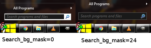

and is that the way you want it?
What happens if you change the text at line 275 from:
Search_background_mask=24
to
Search_background_mask=0
Does it turn white again?
PostPosted: Mon Feb 29, 2016 4:02 pm
Joined: Mon Jan 18, 2016 10:30 pm
Posts: 19
The theme, "Mr GRiM's Dark7 Ultimate Theme for Windows 7" makes many different elements of the UI dark, including the search bar. (And a handful of third party programs) When I changed the background mask to 0 in AeroFlat FullGlass, the outer edge of the search bar was white, but the text box remained black. Personally I have no preference for either a black or white search bar, but I do like the black one better. However, when it comes to searching, I usually use the search bar within File Explorer.
PostPosted: Tue Mar 01, 2016 12:42 am
Interesting.
I kind of thought it would turn all white, not half.
Mr GRiM must overide at a high level. I like it all black too, in this case.
Thank you for the experiment.
