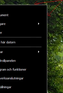

I want a complete black menu, so i have set it to solid color black, but i can't get rid of the white border around it.
How do i get rid of that white thin frame around the menu?
(the red arrows points to them as shown in the screenshot.)
I don't understand which code that is i have to change to get it total black without frames?
I'm using Resource hacker.
Help appreciated!

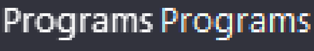

Hi Corso.
I don't have time to help you, but I found a fuzzy look on some skins if opacity is not alpha.
See picture. Is this the kind of blurry?
The left was either full glass, or region. The right was alpha.

I've tried them all opcacity fullglass, glass, alpha etc..
but still the menutext looks weak, kinda fragile. Hard to explain.
When i put the cursor over the menutext the text gets "filled in" and looks right.
But when closing the menu and reopen it it looks the same again. It's weird.

PostPosted: Sun Jun 21, 2015 1:54 am
All I know is, solid makes auto border with grey 100/255. Yours is close to 190/255
Don't know if there is a way to disable it.
I know there is a setting to make 2 pixel 3d border on on Win7 and a mod on Win8.
Sorry can't help. Only the masters know stuff like that.
Might have to use a bitmap again, without any built in border, and opacity other than solid,
and turn off clear type, as GauravK suggested.
