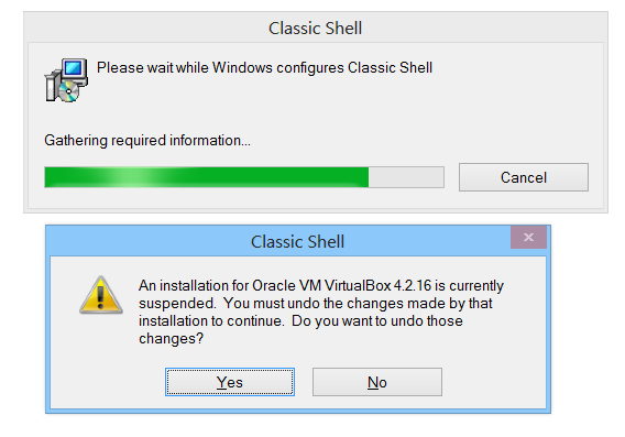

PostPosted: Mon Jul 08, 2013 4:30 am
Posts: 71
I just tried to uninstalled the previous beta version in order to install the new beta. Uninstalling produced the attached screenshot below. I clicked on 'No' and Vbox was uninstalled. CSM still remained so I uninstalled it again and all went OK. Why do I have problems with Vbox? Seems CSM and Vbox on my system have some sort of deadly embrace.

PostPosted: Mon Jul 08, 2013 8:10 am
That's quite weird. It is possible both softwares share a GUID somewhere but the odds for that are very slim. It is more likely that the Windows Installer got its wires crossed somewhere.

PostPosted: Mon Jul 08, 2013 9:39 am
I have seen such a message with Windows Installer when an installation of product X didn't complete and product Y's installation was started. So I guess there is no conflict as such.
