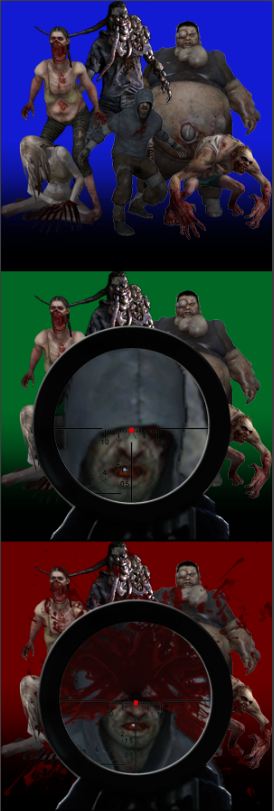

Below is an Example, the Original Can be found Here:
