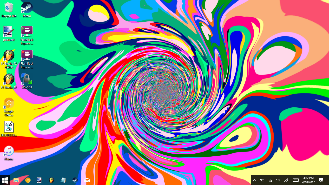

PostPosted: Tue Apr 18, 2017 2:00 pm
Posts: 25
Location: usa
Hello everyone!
I'm having some trouble with Classic Shell today.
My Desktop looks like this:
Can anyone help me?
hi
PostPosted: Sat Apr 22, 2017 3:13 pm
Joined: Wed Apr 05, 2017 6:55 pm
@AcroGen
Are you using textures in taskbar?
I'm having the same problem with textures.
See: viewtopic.php?f=7&t=7464
