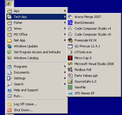

Using Classic Shell, I am still unable to reduce the width of the task bar when it is on the left side of the screen. Selecting the edge and dragging works fine. However, it does not allow reducing it to the typical 1/4 inch size that WinXP allows. Yes, the icons are a small size ... see attachment.
Note that along the bottom, it can be reduced to the 1/4 inch size.

That's because Classic Shell does not control the size of the taskbar. It is up to the OS.

Is there a way to reduce the size of the task bar as XP does?
Also, is there a way to reduce the size of the icons as XP does? ... see both attachments.

I don't know a way to change the size of the taskbar. You can set the menu to use smaller icons from the Skin tab.
