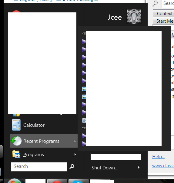

so the text for that skin is black for you?,its white for me, which im fairly certain is the color its suposed to be,
Main_text_color=#F0F0F0,#F0F0F0,#F0F0F0,#F0F0F0
this variable within the skin sets the text color to a very light gray.., so window blinds has to be modifying the text color, try looking through its settings...
attached is a photo of the background from my desktop
