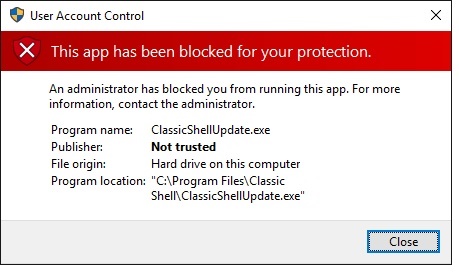

Windows updated and now ClassicShell Update will not run.
i have tried to change the user account control settings but it doesn't help.
does anyone know how to add classic shell as a trusted publisher?
File comment: error message displayed on the screen

The digital certificate of the version you have is expired. You need to uninstall that version, then install the latest 4.2.5c. It is the same as 4.2.5, but with a new certificate.
