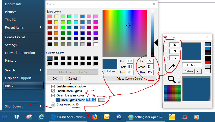

I don't have time to change over to old Win 7 hard drive, but I know using CSM version 4.3.1 works ok.
Here is a screenshot of Windows Aero Opaque Mod.skin on Windows 10 with your new color.
If you did not know, if you input a hex color into the box it has to be bgr not rgb
Here I switched to Open Shell ver 4.4.131
The bottom of the menu and taskbar match exactly r25,g83,b127
Works for me. Make it pink if you want. Will still match. :lol:
How do you like the optional button I put for the second column.
I borrowed the taskbar button from Aero msstyles dll :)

Apart from your mare-m windows theme from overriding something,
sometimes, it's the simplest of settings that can send one in circles for hours.
Besides picking the correct skin, selecting opaque menu option, Menu override glass color 7F5319 /Menu glass intensity 100 /Menu color blending 0 settings,
there is one setting in the Windows 7 "Window Color and Appearance" settings window that may have got turned off by your theme.
It is the check box named "Enable transparency". Sometimes it might change the color a little when turned off.
