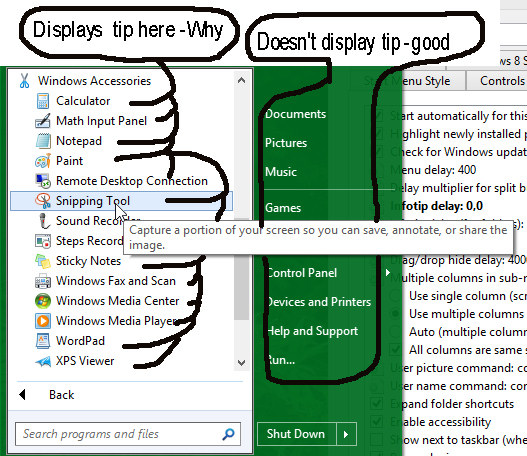

PostPosted: Sat Aug 10, 2013 6:36 pm
I'll try and say it another way. I'm not the best communicator. Ok, here goes.
If I disable the infotips in "Classic style" and "Classic with two columns style",
then the infotips don't show in the menu, or submenus. Good.
If I disable the infotips in "Windows 7 Style", they still show up in the Window's Accessories,
Windows System, Windows Accessories submenus. Bad.
No big deal, just funny inconsistency between the styles.
The other comment I made, is giving thanks for incorporating the infotips, see picture, in the setting up tabs,
eg. "General Behavior", "Customize Start Menu". As these have a different behavior, showing up regardless of settings.
They provide a lot of useful information for customizing the menu.
Thanks. :)

PostPosted: Sat Aug 10, 2013 8:39 pm
What do you mean by "show up in the Windows Accessories"? Do you see a tooltip for the folder itself, or the shortcuts inside the folder?
PostPosted: Sat Aug 10, 2013 10:22 pm
Hi.
I think they are called infotips. Maybe means the same thing.
They display for the shortcuts inside the folders only.

PostPosted: Sun Aug 11, 2013 7:58 am
The infotip settings currently only control the menu items. The programs are in a tree control, which has its own rules about tips. I will try to get it to follow the same settings.
