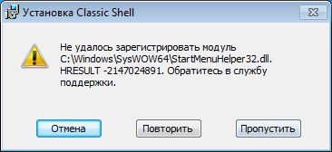

Hello I installed Classic Shell 3 months ago it worked fine, but recently lost the "up" button on the Explorer Bar. I uninstalled the Classic Shell, reinstalled it, but the "up" button has not appeared. Also when I install, this window appears:
Installation Classic Shell
Failed to register module C: \ Windows \ SysWOW64 \ StartMenuHelper32.dll HRESULT-2147024891. Contact your support personnel.
Skip cancel repeat
how to get the Up button?

This error means "access denied". Unfortunately it is hard to know what is failing.
Choose Skip. If this is the only failed module, the only thing you are going to miss is the ability to Pin programs from inside 32-bit file browsers.
You can also try manually registering the DLL after the installation completes. Use this command from an administrative command prompt:
Code:
regsvr32 C:\Windows\SysWOW64\StartMenuHelper32.dll

I entered the message on the command line code:
regsvr32 C: \ Windows \ SysWOW64 \ StartMenuHelper32.dll
poâvilosʹ window
RegSvr32
Module
"C: \ Windows \ SysWOW64 \ StartMenuHelper32.dll"
Downloads
But not been possible to perform Call
DIIRegisterServer,
error code
: 0x80070005.
For further extra statement about this error Perform search on the Internet, indicating the error code as argument results.
Button "Up" on the panels conductor Tak and poâvilasʹ what to do?

Most likely you are not using an administrative command prompt. Type "cmd" in the start menu, right-click on "cmd.exe" and select "Run as administrator".

Сделал, я как Вы написали, то же самое получилось.

The most likely something on your system has the wrong permissions. Use software like Process Monitor while running regsvr32 to see what paths are being accessed and to find out exactly which operation fails.
