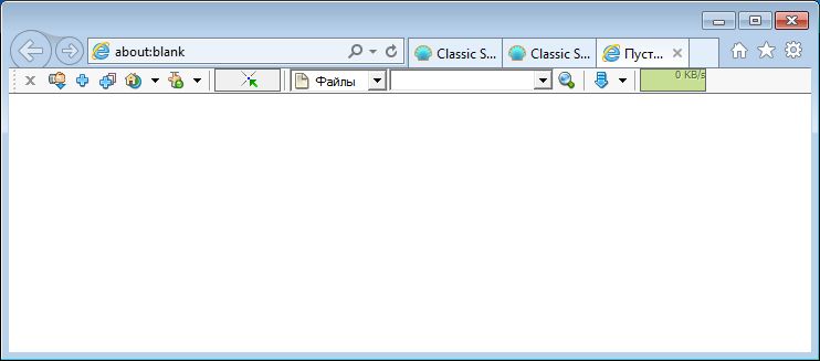

Tell me where in Internet Explorer 11 is the Tools menu

PostPosted: Wed Jun 25, 2014 7:15 am
Press F10 or Alt+T. Or press Alt+Space and enable the Menu bar. Or left click in the top left corner of the IE window and enable the menu bar from there.
