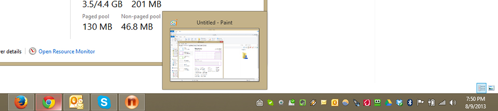

Ok so I finally looked down tonight and saw the clock says 7:50pm and it is like 9:30pm
I got some screen shots for you- the icons on task bar to right are 1 off and the icons to left are not showing some programs that are actually open. I will try to leave it like this to see if there is any info I can provide while the issue is present.
One pic shows when mouse is over a prog that is not showing- the Windows aero preview or whatever still works. The other photo shows how the mouse is over the Skype icon but is displaying info for Trillian which is to the left of the Skype icon.

C
edit- just added pic of overlap- occurs when CS is closed and reopened. thx
Also- CS is updated after restart but stays frozen- ie- the icons and time change but continue not to update

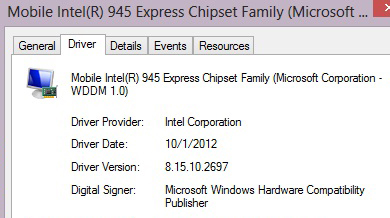

Ya had this machine for years and Win8 for almost a year never had the issue previously. I could run a debugger or something if you think that might help determine what happens. Maybe gpu driver? Thanks.

FWIW:
