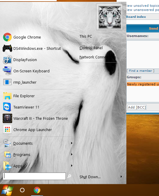

Problem is largely solved. I unchecked the "Enable menu glass" option in the "Menu look" section (see in picture) and it worked but a pop up window opened which says "Skin Warning: The background bitmap 31 and mask bitmap 32, have different sizes" (see in picture 2), is this a problem (maybe for picture quality)?

I can advise to the people who will read this topic that; Dimensions, even numerary of bitmap (24-32) are not important, you can try with different variations for best results, just don't forget to uncheck the "Enable menu glass" option which is located in the "Menu look" section..

I worked on the skin which you attached and finally everything is exactly how I wanted (colors, picture, fonts, transparency etc.).
I could not accomplish it without your help, thank you..
