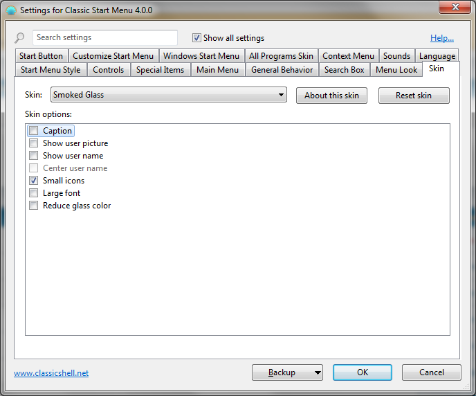

I upgraded from 3.6.8 to 4.0.0. Everything went smoothly, except one small glitch:
All the settings from the Skin tab were lost. Further, upon re-doing the settings, they are not displayed in bold like usual to indicate a change from the default.

The skin settings were never shown in bold in the previous version either so that is not a bug, however the skin getting reset and skin settings lost could be a bug. If I remember correctly, if you have a saved XML, then the skin and skin settings should get imported but it's not, it's ignoring the skin settings from what I tried with Classic Shell 4.0 on Windows 8.1. I will have to confirm with Ivo.

Each of the 3 styles (classic, two columns, windows 7) has its own separate skin settings.
When you upgrade from 3.6.8 to 4.0.0 the menu tries to guess if you were using one- or two-column mode and set the correct style. Then it transfers the old skin settings to the skin settings of that style. The skin settings for the other two styles are set to defaults.
Does this explain the behavior you are seeing?

The Skin settings really did get lost though.
ClassicShell correctly guessed that I was using classic style, so I would have expected all the settings to carry over. So that does not explain the behaviour.

Yes, the skin settings are not transferred during the upgrade because they have been renamed. It is not impossible, but is currently not being done.

Losing the skin settings is expected behaviour then. Is that true even if an XML backup has been saved and restored?

I would expect importing an old XML file to also have the same behavior. As I said, it is possible to preserve the skin settings and it might happen in a future version.

PostPosted: Mon Oct 21, 2013 12:22 am
In the latest version of Classic Shell, skin settings for built-in settings are correctly migrated. The upgrade notification has been rolled out now for version 4.0 so all the users upgrading from 3.6.8, their skin settings for built-in skins will be migrated.
