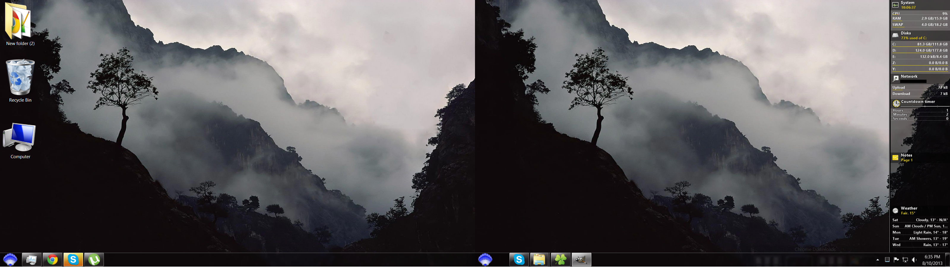

Taskbar Icon Offset on Secondary taskbar Only
Duno what causes it, a restart of classic shell fixes the problem for a time, i know i didnt change dpi or resolution between, and my current settings are 1600x900@125%dpi

I have not seen this before. Keep an eye out to see if you can notice what may be triggering it - a change in resolution perhaps, or a specific software.
Do you have any other programs that may be messing with the taskbar?
Also, if you unlock the taskbar and try to resize it, does it fix the problem?

After further investigation, the problem seems most probably caused by display fusion, but with classic shell, and 7+taskbar tweaker installed as a prerequisite :P
Apparently Display fusion still influences windows default taskbar, even when set not to use its own.
