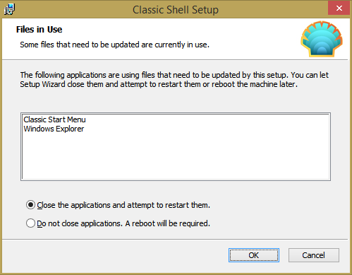

If you get such a message on the screen, try choosing the option: "Do not close applications. A reboot will be required". Then the installer may not hang.
You can also try running the installer with the /L switch to log the details to a text file which will be created in the same folder where the installer is. For example:
ClassicShellSetup_4_0_5.exe /L* log.txt
