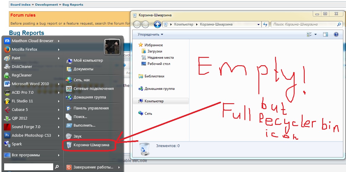

I put the recycler bin icon in my start menu, but it doesn't change after erasing of the bin. How to fix it?
The example (screenshot) in the attachment.
Version of my Classic Shell is 4.1.0
OS Windows Seven x64.
P.S. Sorry for my bad english :)
File comment: Full recycler bin icon, but there is no items

The Start Menu icons are all cached to a file (%Appdata%\ClassicShell\DataCache.db) so the icons will load faster. Unfortunately, due to this, the Recycle Bin icon does not update. The Start menu will have to be specifically updated to check if a link to shell:RecycleBinFolder exists and update the icon depending on the full/empty state. Not sure if Ivo will do this.

Thanks for answer!
But in previous versions of Classic Shell (before 4.*) icon changing worked fine.
PostPosted: Sun May 04, 2014 12:33 pm
Correct because the icon caching to a file was implemented in Classic Shell 4. I agree this needs to be fixed but it's up to Ivo to decide what to do.
