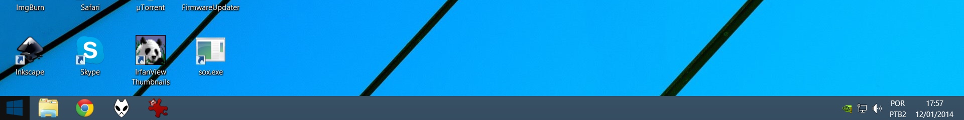

My classic shell keeps halting.
I suspect it could have anything to do with "going straight to desktop" before the standard start screen finishes loading up.
This is how it halts... anyone experiencing the same thing?
Check image attached.
classic_shell_halt.jpg [73.49 KiB]
Downloaded 6534 times
PostPosted: Sun Jan 12, 2014 1:11 pm
Check here how to capture a crash dump even on startup: viewtopic.php?f=12&t=6#p9789

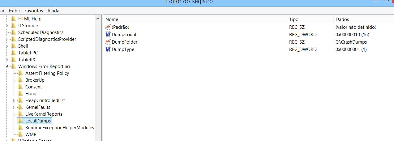

Oh, well...
It seems I am not getting any crash reports.
My regedit configuration is attached. Please advise.
Thanks.
PostPosted: Sat Jan 18, 2014 9:12 am
Did you remember to create the folder "C:\CrashDumps"? Also, look in the event viewer. Maybe an event is logged saying why the dump failed to save.
