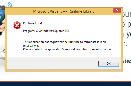

Some of our computers have been getting the error message: "Runtime Error! Program C:\Windows\Explorer.EXE" (For the full error message please see attached image).
This error message occurs for every user, for every computer once. Once you press OK Explorer crashes and then it restarts and everything is well again for that user for that computer. It is annoying though because we have many users in our Active Directory and many computers (University Campus).

File comment: Error Message
