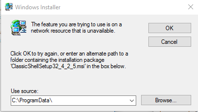

Hello!
I have recently installed Classic Shell on my Windows 10 computer a few days ago. It was working fine when I uninstalled it for something, and as soon as I turned on my computer and logged on, a black screen greeted me. I was able to use the cursor, and Control + Alt + Delete, and running task manager, and from there, I tried to restart explorer. When I did, it just ended it. I went to run task, and tried to run it. It didn't work.
Also, during the installation, my computer turned off. This is another topic, but that might've been the problem.
And, whenever I try re-uninstalling it, it says
"The feature you are trying to use is on a network resources that is unavailable. Click OK to try again, or enter an alternate path to a folder containing the installation package
'ClassicShellSetup32_4_2_5.msi in the box' below. Use (the 'U' was underline for some reason) source: C:\ProgramData\
Thanks!
File comment: "The feature you are trying to use is on a network resources that is unavailable. Click OK to try again, or enter an alternate path to a folder containing the installation package

The computer shouldn't turn off by itself. That might suggest a hardware problem.
To fully uninstall Classic Shell, download the Classic Shell Utility from here: http://www.classicshell.net/downloads/
Run it and select the manual uninstall option. Restart afterwards.

Ah! Thank you so much! It worked!
