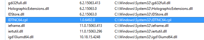

I hate to say it, but you still have the file "C:\Windows\System32\IDTCN64.cpl"

Do you happen to have the IDTNC64.cpl file in C:\Windows\System32 folder? If so, rename it or delete it.
PostPosted: Thu Jul 13, 2017 3:31 pm
Joined: Thu Jul 13, 2017 2:23 pm
Yes I have that file. Having renamed it, Classic Shell is behaving again. Thanks for your help.
Why would a control panel file have such devastating effects?
PostPosted: Thu Jul 13, 2017 5:15 pm
When the start menu launches it collects all items from the interesting folders (icons, names, etc).
I think you can get the same crash when you simply view the Control Panel in Explorer.
