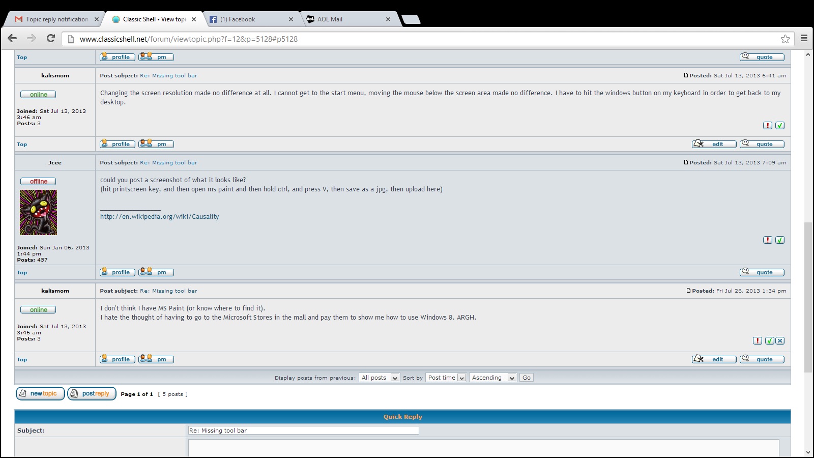

Author:  kalismom [ Fri Jul 26, 2013 1:34 pm ]
Post subject:  Re: Missing tool bar
Hopefully, here is the uploaded jpeg of my screen with the problem:

Author:  Jcee [ Fri Jul 26, 2013 2:25 pm ]
Ok you are in the chrome 'app'
Click Settings (the 3 lines in the top right corner next to your address bar)
then choose "Relaunch Chrome on the Desktop"
that should solve your problem :P
Author:  kalismom [ Fri Jul 26, 2013 3:04 pm ]
I did that and IT WORKED!
Thanks so much. I really appreciate it.:D
Author:  Jcee [ Fri Jul 26, 2013 5:04 pm ]
Glad i could help, and thats actually one of chromes 'features' (that only appears when the user has windows 8 installed) nothing to do with classic shell :P
