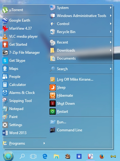

Hi
I have searched the forum for post on removing the white border around Classic menu, but find nothing.
See Clipboard01, then on clipboard02 the white border has been remove (using photopaint) (post preview show the files in the wrong order)
Anyone know how I can achieve this effect, I'm using clrSharp2 Glass with
Enable menu glass
Glass opacity:0
Many thanks
Mike

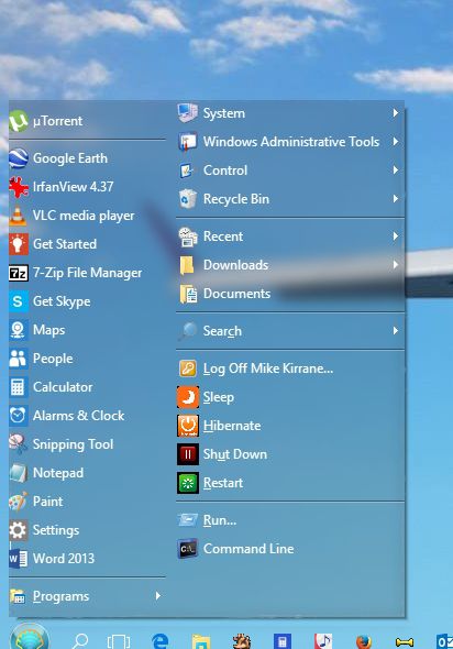

PostPosted: Wed Nov 11, 2015 2:10 pm
That border is added by the skin itself, If you want to do it, you will need to open the .skin file with reshacker, export the appropriate bitmaps. (see: http://www.classicshell.net/tutorials/skintutorial.html for more info) modify, then re-import them. If you would like this done for you, attach the .skin file to this thread, or attach a link to download it. Then someone may decide to take on your request, though the modifications aren't too difficult in this instance.

PostPosted: Wed Nov 11, 2015 6:17 pm
Here's the updated, note the color has changed slightly though. I also fixed the alignment issue on the bmp
btw only the first BMP needed modified. to remove the white parts
clrSharp2 Glass - test.skin [80 KiB]
Downloaded 1169 times
PostPosted: Thu Nov 12, 2015 9:27 am
Joined: Wed Nov 11, 2015 11:29 am
:D
Jcee
Thank you
The Menu now looks awesome, using transparent and "0" glass opacity it just hangs there against the windows background.
