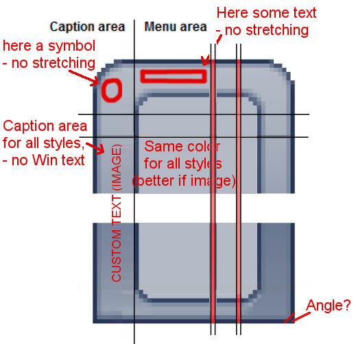

PostPosted: Thu Dec 29, 2016 8:17 am
Posts: 130
Location: Italy
Again, thanks for your answer, juniper7, maybe this could become a "Basics on how to do..." thread, who knows. ;)
To start with something, here's a... simple example.:lol:
Obviously I'm not sure if all is doable.
I think to add all the needed text directly on the image, so, it will be bigger than all those I found in the menu skins.

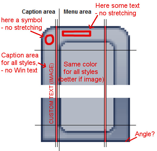

PostPosted: Thu Dec 29, 2016 8:37 am
See attached.
Alternatively, you could use emblems...
PostPosted: Thu Dec 29, 2016 8:46 am
Posts: 130
Location: Italy
Thanks Splitwirez, good to know.
Now I have to find the time to start to play... :lol:
PostPosted: Thu Dec 29, 2016 9:10 am
If the pink areas are the stretching slice zones, it should work.
I gather the vertical stretching area is not colored in for clarity?
I still see it start just below the inner round corners to most of menu.
Edit
On Splitwirez mod picture, guess it can work too.
That changed vertical stretching area would be good to protect image in caption space.
See, I'm wrong. :oops:
There can be 6 safe areas, not 4 on single column, with a modified caption area.
R.O.B. is good for hiding the Windows caption text, and having image instead.
Another thing, caption is for classic 1 style only.

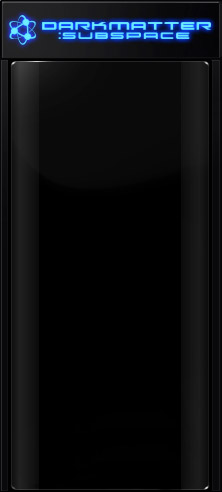

Yes, if you are just going to get rid of Windows caption text with an image of text or picture,
then it's easy. A couple of us have actually put a fake caption picture on a classic 2 column menu.
Other. There is a CSM caption setting that allows user to replace Windows caption with different text.
At least try before giving up. :)
From what I remember a while back, someone was super ticked off about not getting the skin the way they wanted.
Did not help that skin went corrupt. Dang it, what was name on it blue letters,,dark matter,,dark space,whatever.
I think it had text right in the top middle of classic 1 menu. It will distort.
The persons skin was called something like F@#this F*&% skin. Well now that Ivo introduced emblems,
the text can be a non distorting emblem and look good.
So please try and see how far you can go.
Edit: Ah. It was called Darkmatter Subspace
Maybe someone can take over it and finish it. It's probably still there, way back in the pages.
Looks like it came from The Skins Factory.
The text emblem would need to be a bit smaller to avoid being cut off on sides,
when menu shrinks.
