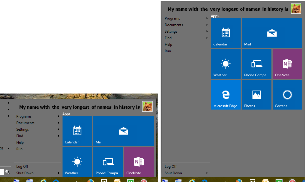

Here is a picture of a couple parts.
It looks like someone opened the window, with text floating in the night air.
Hurry up, and close the window, the text are getting in.
One more.
I don't do windows, I only do tiles. :)
They are burnt in, or embedded into bitmap.
That's a thought. A simpler glass color version could be made to work on Win 7.
Will leave for others, maybe you. :)

I'm not on Win 10 right now to make a screen shot of how the tiles disappear at bottom of real menu, when its scrollbar is moved.
Only you know what you want on the skin, regarding the amount of padding.

Oh. I think I got you now. The tiles disappear when you scroll.
Only a bit of padding on the top. I'll have to try and see.

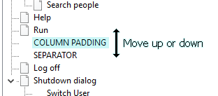

PostPosted: Tue Jan 17, 2017 9:35 pm
The location I was mentioning using regedit is one of the many parent folders in
HKEY_LOCAL_MACHINE\SOFTWARE\Microsoft\Windows\CurrentVersion\Explorer\FolderDescriptions.
I see that the link to Ms expired or did not take capture properly in forum.
The way I see about glass color is, white is included, Win10/8 don't use white in startscreen/startmenu color tables.
One of the pictures explains one of the types of padding, I was talking about earlier.
The other picture I made, then noticed your reply. Uploaded anyway.
You know when all the flashing, rotating live colored tiles are removed,
it looks as boring as the menu I'm making. :lol:
I'll have to spice it up with sriracha.
