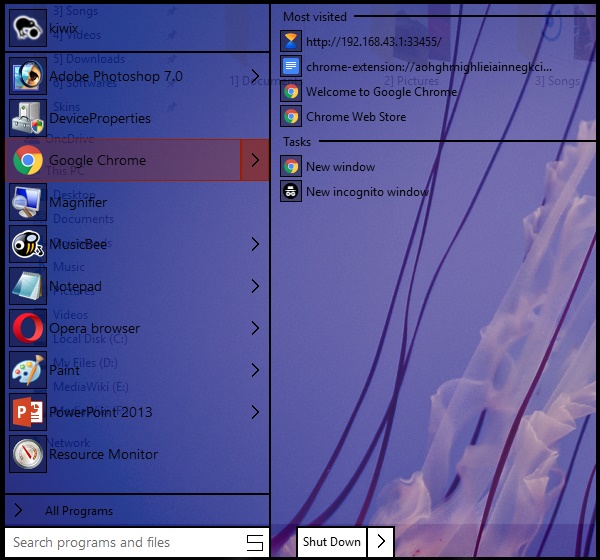

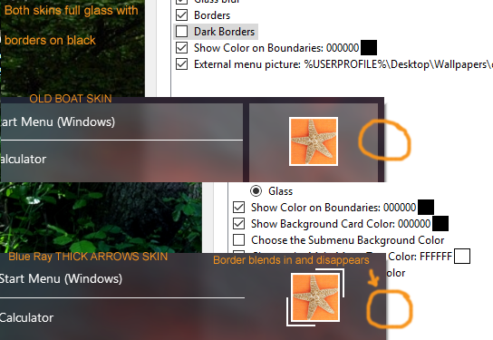

PostPosted: Fri Jun 16, 2017 6:05 pm

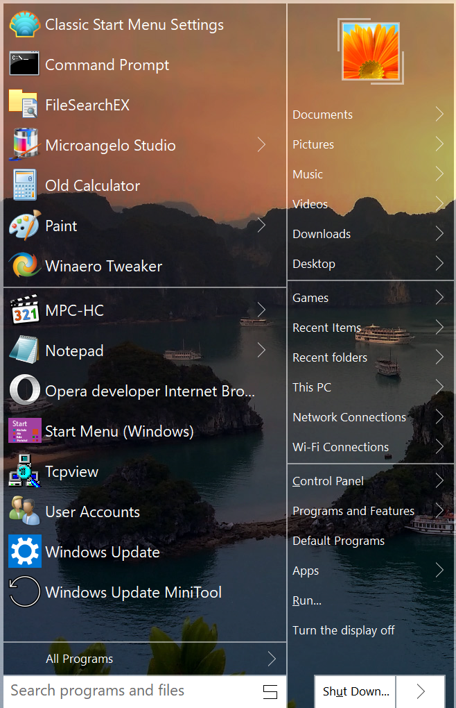

Hi meetHG.
I provided a picture to explain better in a previous post when the boundary border would blend into nothing effect.
That is why I experimented with a black pattern image, to get a stronger darker border. Either way has good points.
If you want more solid, go the pattern way. For more ever-changing blending effect stick with your way.
Something else I was saying from before. It looks as though on your skin,
one can get the opaque border with transparent inner menu part,
by having "Glass Throughout" and "Show Background Card Color" turned on.

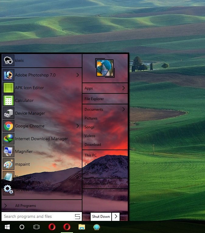

Can practically make the menu into anything you want, using desktop wallpapers as menu image.
The only thing a user has to be aware of, is it draws from the top left corner, if English language.
Sometimes what looks like a wallpaper could look great, isn't, because wallpaper was so huge,
Only a small top left corner part of wallpaper image is seen.
The last screenshot picture is of MS wallpaper, by Adhemas Batista with your latest (not modified) skin .
What's next color picker separators? :)

PostPosted: Fri Jun 16, 2017 10:24 pm
Posts: 90
juniper7 wrote:
Hi meetHG.
OK, I understand it. Yeah, I see that there is no distinction. Actually this is due to the fact that both the background card color and boundary color are same and being of same intensity in the Main_bitmap_mask, they just appear to be one. If you want to increase the border intensity, then increase the intensity of green channel.

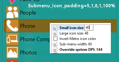

I want to check out some things Gaurav said about HiDPI.
I don't understand about icon frames in submenu?

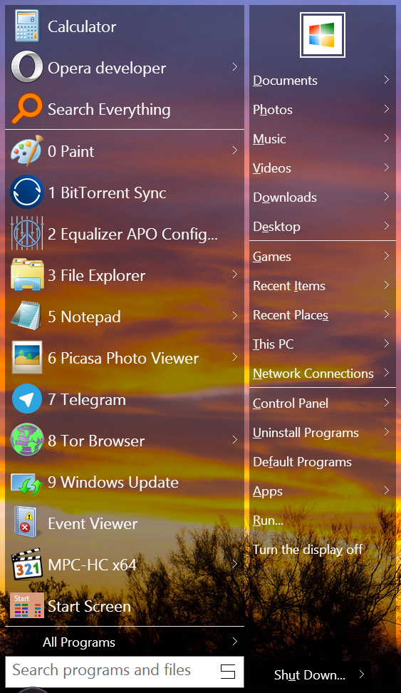

See picture of search view. It looks ok. I did not do anything yet to paddings.
If I change what you have
Shutdown_text_padding=10,6,10,7
Shutdown_icon_padding=5,0,-5,0
to
Shutdown_text_padding=10,6,10,7,100%
Shutdown_icon_padding=5,0,-5,0,100%
The size will increase automatically with increase of DPI.
See picture. I think it would be a good idea to see where the ",100%"
are in the Metro skin, and copy over to your skin.
I see Main_text_padding=0,0,0,0
All other text padding have higher numbers.
I notice main font size is different. Is that what you want?
Main_font="Segoe UI",normal,-11
Main2_font="Segoe UI",normal,-9
Will get back to you later if you need anything.
Bye. :)
PostPosted: Sat Jun 17, 2017 8:57 am

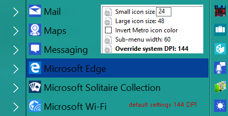

I'm guessing Gaurav may have the small icons setup in CSM to be instead of default 24 size for submenu at 144DPI,
that they are around 40 pixel size? That could be it!
Here is picture of submenu at 144DPI. of your latest skin. No changes to any paddings in submenu were made.
PostPosted: Sat Jun 17, 2017 9:09 am
My small icon size is 40, large icon size is 48. The DPI setting in Windows is set to 150% (DPI 144). Actual display PPI is 176 pixels per inch.
PostPosted: Sat Jun 17, 2017 9:28 am
OK, Gaurav. Wow. 176 . I'm surprised screen isn't blurry, if not divided evenly?
I think it's best if padding increased at least a tiny bit. I know meetHG likes everything tightly packed.
This could work:
Could increase just a little bit from
Submenu_icon_padding=5,0,0,0
to
Submenu_icon_padding=5,1,0,1,100%

PostPosted: Tue Jul 11, 2017 7:29 am

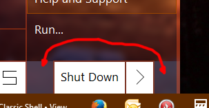

1. Shutdown button is not on the same row as search box. It is more noticeable since it is white now.
2. Right column vertical padding is too less. Earlier version was OK.
3. Need separate submenu arrow color option
4. Split button right portion (Jumplist and shutdown) is still way too small (but it's like that in the default Classic Shell skins too) :P
Here's a pic:
PostPosted: Tue Jul 11, 2017 7:53 am
Posts: 90
OK, I got it.
1] Shutdown button needs a little things- a 100% behind the text. I was adding it before uploading the skin but forgot. On normal DPI (96), search box and shutdown button are nearly in the same row.
2] The reason for this is HIDPI. No problem I will add new bitmaps to adjust them. Below is the screenshot at 96 dpi. Here it looks OK, if not perfect.
3] OK I will add it. One question- Earlier when I was making the skin I changed the tint of arrows and user frame to match the accent color. Although I removed it now, I want to know that If earlier settings were more better or not?
4]I will adjust the padding.
Thanks for help.

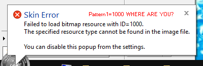

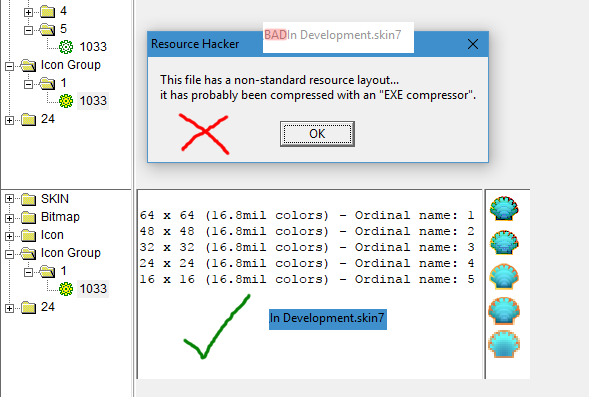

I downloaded the damaged #3 skin. Works for me with v3.6.0 Reshacker
Upon trying in CSM just a white default menu, unless a picture image is added.
The power button looks unique, with the transparent border frame part,

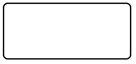

just like the separators. Symmetrically placed, at least in English language.
Looks alright. I tried some options.
I see so many 'select', but is there selector button color option?
I don't remember, was there a selector button color at one time, or was it up to user to use override glass color?
Circle frames are different, still neat with broken part.
Downloaded #2 good skin.
Ok, same thing. Only white default menu, unless click box /user picture image inserted. I see your note now. Kind of weird. Even if I change 0 to 1 in your file,
OPTION_IMAGE PATTERN1=Select Different Image as Background,1
and reset skin, it still starts out CSM default white skin?
P U. Ok, got it. Pin Unpin.

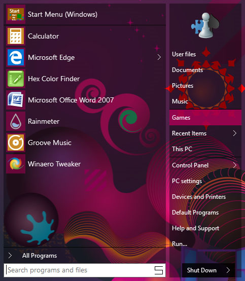

Below are some screenshots of what I was talking about italics stuff in previous reply.
Did something like this happens to you ever? If yes, thank god. I am not the only one. If No, but Why me? This thing has ruined my skins from the start. When I nearly done all the changes, this happens and I have to start over. But afterwards I found way to tackle the problem. But It is still irritating.
I also saw that you are using the old version of reshack. And every other one on the forum seems to use it.
Let me know why? I am using the latest version.
Yeah, I was thinking about it. Is there any code for making it centred symmetrically? As when the width of second column changes, This alignment change.
May Be Ivo know it?
I changed the word "Choose" to "Select". As why should we become "CHOOS - E" :lol:.
It was always like that. Selector Button Colour Option Always point to the glass colour.
I don't remember of adding it.
Yeah, You are right. These things don't seem to work.
For example, If I add like this:
OPTION_COLOR ACCENT=Select the Main Menu Accent Color,1,TRUE,#640000
And we reset the skin from the settings menu, we will see that option is not enabled, instead it will be off.
And when we enable it, it points to #640000 color.
I don't know why.
P.U. And M, M for More.
Do you like these?
OK, If this what Gaurav means, then might it be corrected using 100% behind the Main2_text_padding.
I never tried it. Might it not work.
You can try it.
Yup, I am going to add a beautiful picture when I found one.
May be in two or three days.
I was thinking of removing transparent and glass option from the Main menu transparency settings as they don't look as great as solid. And Like before, Glass and transparency don't works unless a background card colour is selected. I also found a bug- During transparency and glass setting enabled, Search background is still solid. It is due to that Search_background bitmap has no transparency. This can be corrected, but it is needed only if glass and transparency settings are available. So, Should I remove them or not.
One more question- What do you think skin has got better or worse than before?
Bye.

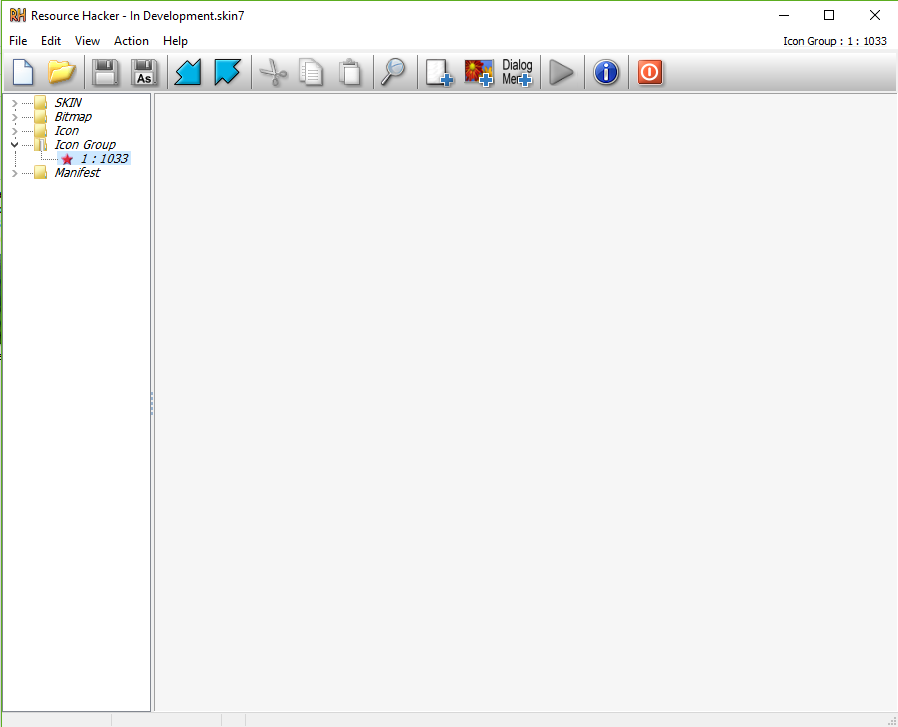

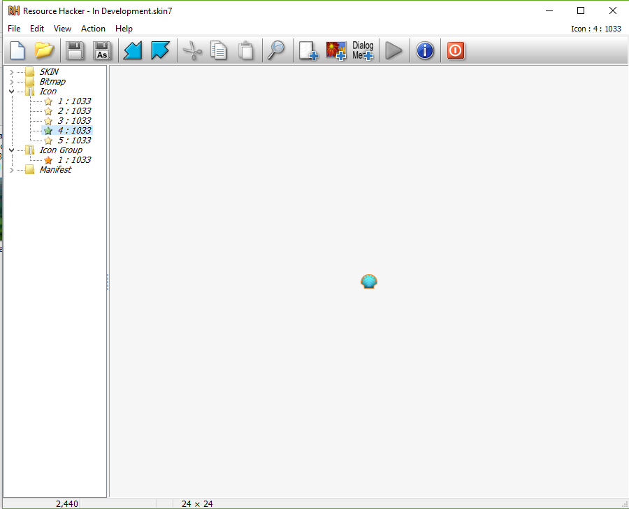

Just a quick reply, for one of the issues.
I went back to look at good and bad file. Ok you are right. I don't really care about what the font view looks like. It can be changed anyway in Reshacker.
Are you going to change the icon inside for a personal one, to show up in the "About" box?

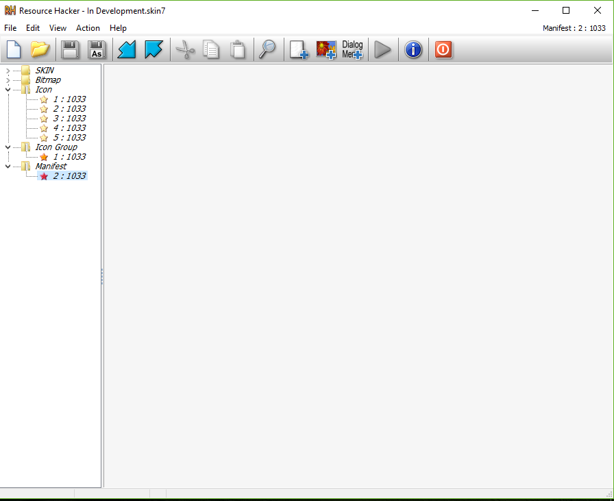

The font of Reshacker 3.6.0 stays same but icon group does not show properly.
Stuff like that has happened to me before too.
Like when I make an extra skin folder. It is usually my fault, because I targeted it to use a garbage text file.
I found the new Reshacker versions more complicated to use. I did not like the way its search worked. I had to make sure compile button clicked each time before search could work, and never figured out how to add images, like you have, so I just use old one.
The old one has a problem with transparent bitmaps sometimes. Sometimes can't replace the bitmap, until it is deleted first. Happens a lot with a user picture bitmap.
The old Resource Hacker is here:
http://www.classicshell.net/forum/downl ... hp?id=2723
Enough time for one more thing.
[centered symmetrically]
Someone awhile ago, asked if every menu entry could be auto centered. They have a mock up picture.
Ivo said not possible.
Still time left. OK, one more.
I think it was redblade8 that had a problem with user picture option showing,
even when put to 0 instead of 1. I think we ended up using a different name than the default "USER_IMAGE". So sometimes there are work arounds that can work. Even if a tiny little 1 pixel image all that's needed for default without external picture image?
Bye
PostPosted: Thu Jul 13, 2017 2:26 pm
Here is a little bit more. We have too much info to converse just in one post.
Errors in Reshacker. Whatever version works for you.
I would change the way you save the file. Most of time now, after clicking the compile button, I just click on the exit X of window, then it asks if I want to save, yes, save as type, select all files, highlight the file, click save, and it overwrites the file. The only problem is easy to overwrite the wrong file, and your backup just vanished.
Sometimes I mistakenly opened up an older file, made changes, and quickly saved, without realizing it just overwrote my newest file in a different location, because program holds onto last location of file, that program used before.

Looks like old Reshacker have problems too.
And for image adding, I just invented a little naughty trick.
You know, If you add a bitmap file, it goes to bitmap folder in Reshack automatically.
and If you add a png imge, it goes to PNG folder automatically.
Same with icons and maybe with some other file types too.
But we want to add images to image folder, not to the png folder.
So, I just first add to an .res file (which don't have automatic folder created) and name the folder "Image".
After this, I replace the .res file with right image what we wanted. 8-) :lol:.

PostPosted: Thu Jul 13, 2017 9:41 pm
Posts: 90
I use the Save button in the toolbar to save the file.

Hi.
Say what? Huh?
I thought you made a final decision that you were going to cut out the main background transparency/blur?
Opaque background still looks best, because it doesn't look milky, and more intense.
Am I missing something? It just seems redundant with the Main Menu transparency/glass blur options up there.
Can't those two radio options be put under the Show Background Card color option, that only enable when card color picked.
And maybe default true is 000000 black?
I did not notice transparency, or brightness difference with main/search views. What options were on at the time?

Hey, Try the menu at HiDPI, I made some chandes to the paddings in list and submenu veiw. See if they look ok or not.

I can put at 144 DPI, but my monitor is not same as high density systems like 3200 x 1800.
It looks ok to me. But if you are like Gaurav, in order for it to look good and work properly,
he likes arrow padding boosted, vertical second column text padding increased,
and more vertical Submenu_icon_padding=5,1,1,1,100%, all for 144Dpi.
(What you put is half good. Submenu_icon_padding=5,0,0,0,100%. I doubt 0 will multiply to anything higher than zero, though)
It would be great if there was a second opinion from someone with one of those monitors.
On my monitor 144DPI size makes menu huge.
I have to sit four to five feet away.
[translucent bars] see picture
I guess it's part of search background. I see tiny multicolored bitmaps, cute.

Hey, I don't know from where these bars come. Can you please elaborate with a bigger picture. :?:

Yes, rectangle with round ends. To make it go a little faster,
I made templates that can be used over, and over with PixelFormer.
You know I started making the split selector with a vertcal line.
The more I made, the more dirty they looked. I had to stop that design. They looked too porno, if you know what I mean.
See picture, I'm not putting that in my updated skin. I made it different now with a complete circle.
Now, I must have made about qty 50 so far. Then I had an idea to make a smaller circle at end.
It looked better, but it is too late. I have committed myself to the second version, not the third version.
I'm not starting over again.

PostPosted: Wed Jul 19, 2017 6:15 pm
Hi meetHG.
I spent some time with skin.
I don't know what is causing that bar at the bottom.
Clues:
At 144 dpi visible as in picture.
If dpi reduced a little or menu height is reduced, bar goes lower.
Turning off search box makes it go lower, but not disappear.
Hiding shutdown button shows bar all the way across menu, including side borders.
Put internal black pattern image, looks ok, then same picture again, same problem.
Try a number of different external picture images.
Most good, 2 bad. It appears to take portion of top image and put at bottom ?
There has to be a 1 or more pixel height that is getting stretched with menu.
I'm tired now. Time to call it a day.
Good night.
EDIT: Top is bottom as tile means repeat. :lol: :x :lol: :P:o
Nothing wrong with your skin. The tile just repeated itself, because it's a patterned image.
