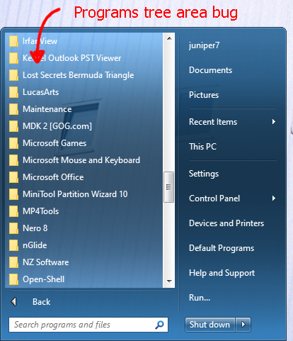

I brightened up the shutdown button. Even looked at the original button in Msstyles. It looks the same dark. I guess I know what premultiplied images are now. It compresses everything darker. Don't know the formula to reverse it, so I brightened rgb to the max, then brightened alpha channel appropriately. Added option for half user picture glare, or none. The original glare is too much.
Skin appears to work ok in High DPI. Had a problem with the user picture showing up when it's not supposed to.
I think it's fixed now. I separated the text from regular HIGH DPI. I did not copy every little detail from the original.

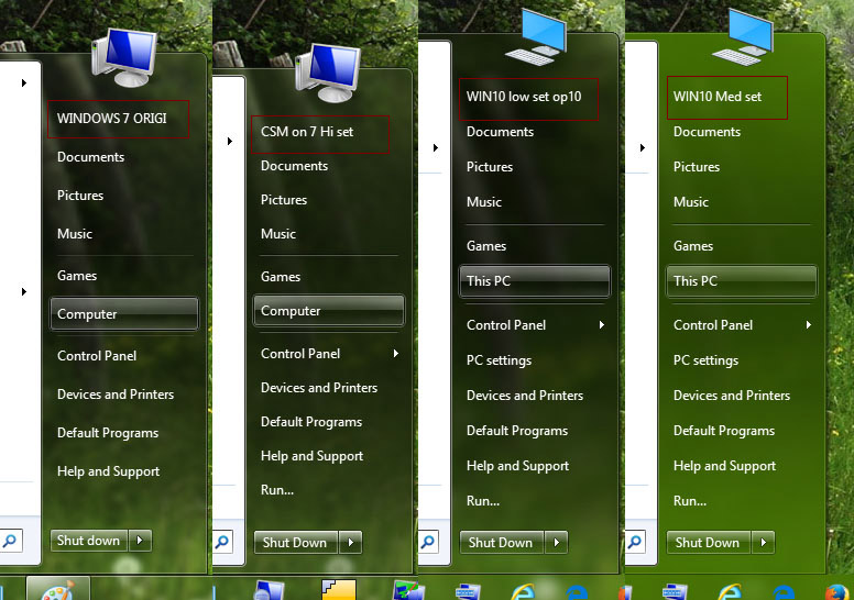

Ok, so on Win7.
Set menu to "High" option.
This will match the taskbar in most cases, except when MS does some brightness twiddling,
which I could not find out how. I am only a layman, so I guess there is a different glass color access point, or
Einstein formula going on the system?

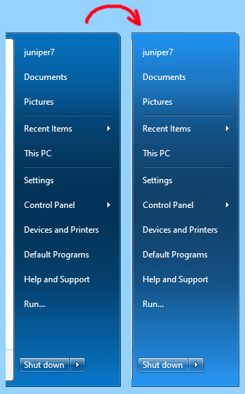

I decided to add an option to make the skin more usable on Win 10.
By decreasing the glass opacity, the strong dark Win 10 colors are reduced to resemble Win7 start menu.
Win 10 uses totally different properties, so don't expect too much. You won't have the wide variety of colors to choose from.
I was thinking of putting the Win 7 diagonal bars in the alpha channel of the menu bitmaps, for Win 10 use.
The skin would have to be huge, so forget it.
Anyway, if you are on Win10,
pick the "low" setting, pick "On Win 10", and set the "Taskbar opacity", (in CSM "Windows 10 Settings" tab) to 55.
If you want more blur, you will have to go into the menu look tab.
Change the "Glass opacity" to 25, and "Taskbar opacity" down to 30.
The "med" option, with "On Win 10" is more like the original CSM Aero skin.
Set taskbar, and menu glass opacity back to regular values, for matching taskbar.

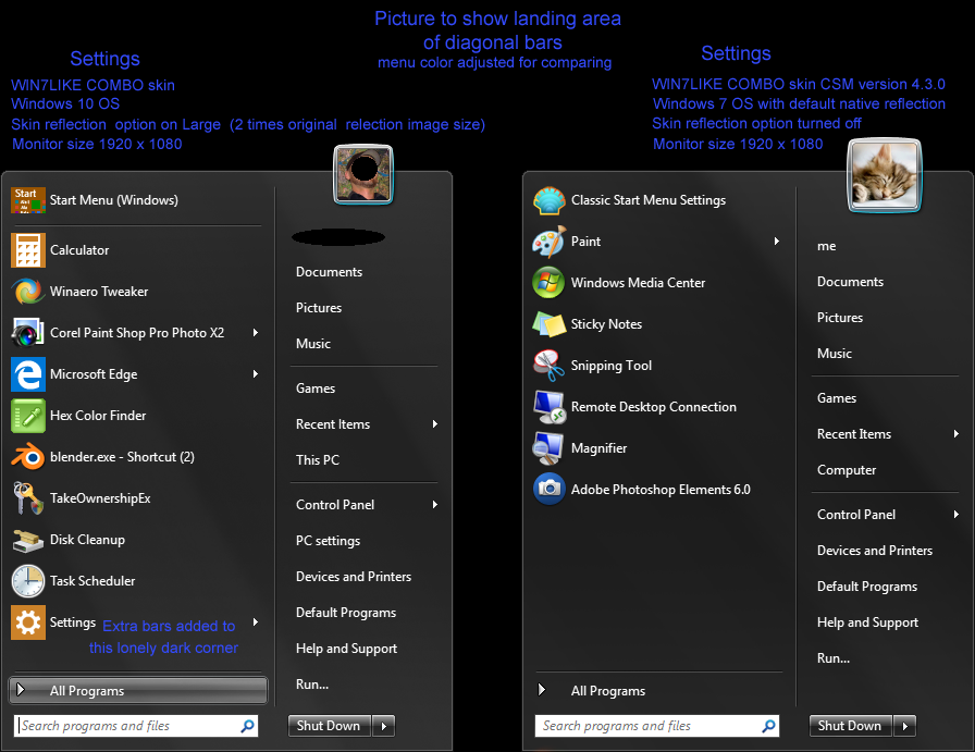

EDIT: Just changed the picture, to show the highlight red squares for two different operating systems, for comparing.
I probably made close to one hundred bitmaps with minor & major changes along the way, to get skin the way it looks.

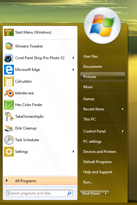

EDIT: Added option; white text with shadow on glass areas.[WIN7LIKE COMBO revC.skin7]
EDIT: I forgot to put picture frame for 84 pixels. [WIN7LIKE COMBO revC.skin7]

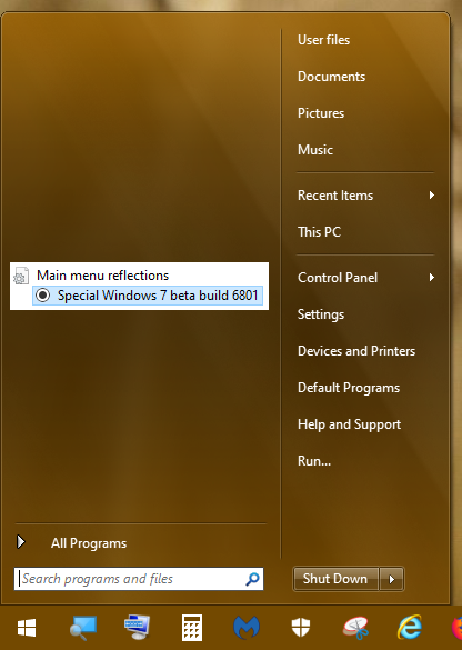

EDIT: There is also "WIN7LIKE COMBO revD" skin.7 at bottom of post.
It has a request to include the reflection diagonal bars image from Win7 beta build 6801.
The image is slightly different looking.

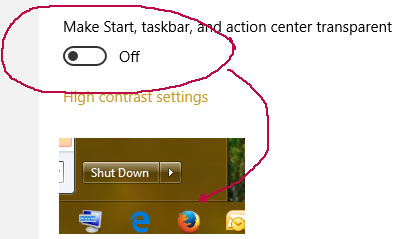

Thought I'd mention this.
Windows makes the taskbar have two types of brightness.
If you are on Windows 10,
and want to have glass taskbar roughly match to medium setting menu,
Turn Windows personalize settings "Make start, taskbar, and action center transparent" to Off
Have CSM "Customize taskbar" set on "Glass"
and of course, check mark the " On Win 10" option.

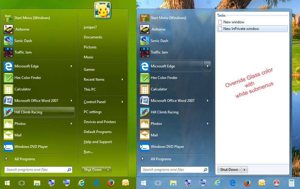

Note. If you want to experiment with Ivo's Override glass color,
set to high skin option
enter DBA664 into the CSM "Override glass menu color setting", and "Taskbar color" boxes & click ok.
To have taskbar match have at 0 menu opacity, taskbar 70 opacity for wax paper look.
( Shows my age. Does anybody even use wax paper anymore?) :lol:
or regular menu opacity 50, taskbar opacity 85
or opaque menu opacity 100, taskbar opacity 100

Kind of late, but I'm working on it now.
It will not look exactly like Win7 shiny bars, but close enough.
Will probably finish this weekend, unless I die shoveling snow.
See the picture of what it looks like so far today.
I'm adding all those bigger size picture frames.
Using the Full WIN7LIKE skin, modifying to have the standard split white option.
It's really for Windows 10, because of use of "$Metro colors"
I'll put small -8 size font option if it helps people with newer HiDPI screens.
Expect Greatness.....not in the features, but in size of the file.
Right now, great file size is 2.42 MB :lol:

Yeah, the reflection image overlay didn't work out too well.
The way I think Windows 7 does it, is take the diagonal bar image in Aero theme.
Then it gets enlarged to match whatever size desktop is used.
Then it is displayed as an alpha layer.
So if start menu is at the bottom left, then the same corner of the reflection bars will show through.
Have a look at the picture right side.
For Classic Shell, Ivo states that the pattern image begins in the top left.
The bars will show in wrong location, as well as possible different angle.
So right away, it is never going to match exactly the correct corner.
Add to that, the pattern image used does not stretch.
I can take the reflection image from Aero theme file and enlarge it exactly for my monitor resolution,
then temporarily display it as desktop picture behind the menu,
then crop that so the top of menu starts at that exact same location when using as the pattern image.
As you can figure, it's a lot of work, and only works for one size/dpi monitor.
It's impractical for me to make a large number of different ratio sizes to fit for everybody,
and the file size would be huge. Just one full-size reflection image is 2 MB!
If I put the pattern image as a stretchable green mask, it could kind of work,
but only if the height/width ratio stays exactly the same,
which is impossible with a stretching menu. I skipped that method.
So this is what I did, for the small reflection option:
I took the original image 802x596, added some extra bars at the corners,
then copy/pasted to itself to be a bigger 1280x1200 so it won't tile repeat.
It is not blurry enlarged.
The medium size, I stole from Clasetro skin. I forgot how I made it originally.
There was a lot of processing involved.
For the large option, I enlarged original image 2 times, added extra corner bars.
The angle of bars will not match original Win7 look, but hey, life is a compromise. :lol:
This one is blurry enlarged.
To be subtle, all three options use pattern masks that only let through around 20 to 30 percent brightness.
Note. This might slow down menu animation on slow computers, like when opening jump view.
If anybody wants to try enlarging the unaltered reflection image for their own desktop,
it is image #190. Use Resource Hacker.
It uses OPTION INTERN4
See bottom of text file skin to see pattern masks used.
Those masks let about 50 percent brightness.

Included a diagonal bars reflection image from Win7 beta build 6801. Was requested by Felix
Added shutdown button look option. It has a resemblance to the other 2nd column button and static view of the beta 6801 button.
Changed option so anyone can add a custom modified reflection image.
The image is blended around 50% with the menu and will tile repeat if too small.
Windows 7 applies their reflection image starting from the top left corner of the screen, as well as auto enlarging to fit desktop.
Classic Shell cannot do that. The same image in CSM will start at the top left corner of the start menu. Big difference!
The image would need to be enlarged in a photo editor beforehand.
Moving parts of the image around in an editor and cropping an enlarged image sweet spot can get close to faking the Win 7 original look.

Also
In most cases, the combo skin on Windows 10 OS
with its Win10 "Transparency effects" turned off and "Auto accent color" enabled,
one can get the menu and taskbar roughly the same brightness.
High option= Menu opacity 50, taskbar opacity 85. Example with CSM color BGR 933800 override
High option= Menu opacity 5, taskbar opacity 70-75. Example with CSM color BGR 933800 override
Med option= Menu opacity 50, taskbar opacity 85. Auto accent color enabled
Med option= Menu opacity 5, taskbar opacity 72. Auto accent color enabled
Low option= Menu opacity 50, taskbar opacity 58. Auto accent color enabled
Low option= Menu opacity 25, taskbar opacity 30 to 35. Auto accent color enabled
Using themes (for example Hawaii), or even some Windows custom colors can have big mismatches on CSM.
It's also difficult to get an exact match all the time, depending on the lightness/darkness of the background behind the menu.
One has to give the Microsoft Win7 designers and coders a lot of credit for working out the exact calculations with the varying color, brightness, and transparencies to get the best taskbar/menu matches.
It's weird how optical illusions and old type LCD screens also play a part.
If I set the menu/taskbar opacities to what my eyes think are ok,
and then pull up the taskbar a few inches with the start menu above it,
it suddenly becomes evident that it doesn't match.
It's all to do with the lightness/darkness of areas around what one is looking at, as well as tint and brightness shifts of LCD displays.

The start menu will appear opaque and darker as there is no lightness from the desktop behind.
If you haven't already done it, set the skin option to "Brighter Metro color",
Then if you use a favourite color picked in Windows "Personalize-Colors" "Custom colors",
you can boost the accent color brightness.
Move the slider to the far right.
You can also use the "Override glass color" in "Menu Look" tab of Classic/Open Shell as well.
Just slide the big black arrow up a little.
As long as the Metro color (Windows) is exactly the same picked color in Classic/ Open Shell,
or else the different colors will give an unexpected mixed color.
I just found out "High" skin setting might work better in this case.

There is another area that does not work correctly if the "Enable menu glass" is unchecked
in Classic/Open Shell settings.
This setting replaces a glass start menu look with a darker transparent (no glass) effect.
The problem is, that the inside programs tree area becomes brighter when opened in this specific 7-style full glass skin (.skin7).
It does the same on Smoked Glass 7-style skin (.skin7).
I think it is because the software code does not know what opacity/color to use as the skin bitmap has a gradient.
The code may not apply the special non-linear alpha transparency code. It works perfectly in glass mode.
Anyway, if anybody does use the 2 column glass option and it bugs you, go to
