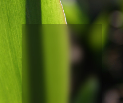

hey Ivo, Jcee
is there a possibility to blur the background shining through the menu like it is in Win7?
I mean something like that:
PostPosted: Sun Jan 20, 2013 5:02 am
Main_opacity=fullglass
makes the background transparent and blured, although in windows 8 its about half as transparent or less, compared to windows 7.. (and it maxes out at like 40% transparent or something, aside from pure alpha)
Main_opacity=fullalpha
shows transparency as it really is (aka you could have a menu 1% visible)
but doesnt have blur
those are our current options, although i wish he could/would tweak the algorythm for fullglass to be a little more clear
an alternative however, that i havnt quite tested is rainmeter (making a blured square behind the menu, but you would have to adjust its size every time you edit your specific menu.. and it would be a bit annoying, and there may be layering problems (idk if topmost layer would be above classic shell or below it, but it should be above, most regular windows applications, then u just need a way to trigger the skin to show when classic shell pops up
PostPosted: Sun Jan 20, 2013 9:12 am
Windows 8 doesn't support blur. The only program I've seen that tries to emulate the blur is ViStart, and it doesn't look very good.
PostPosted: Sun Jan 20, 2013 10:27 am
just googled it, and from the screenshots i don't think it looks that bad, the particular blur seems a tad strong (but they call it ultra blur..), but im sure you can tweak it; although he does mention quite alot of work was put into its creation..
gimps open source maybe you could use there Gaussian blur algorithm (it seems pretty good set at 5 pixels :P, but that could be decided by the skin probably (or default at 5 if not defined in the skin))
PostPosted: Sun Jan 20, 2013 10:35 am
The problem is not how to blur the image. It is capturing the image behind the menu in the first place. It is actually impossible if there is animation going on. Also once you start opening sub-menus that overlap, it gets even trickier.
Basically on Vista and 7 the OS takes care of compositing the windows on top of each other. For best results the blur must be done during that compositing. Without the cooperation of the OS it is not possible to get good results.
