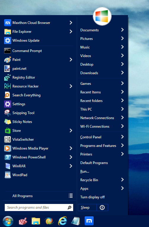

On Windows 10, the Classic Start menu color does not exactly match the taskbar color. This is similar to how the Windows 10 Start menu behaves whose color also does not match the taskbar color. But if you want a menu skin that matches taskbar color, you can get it in this thread.
If you are using an opaque Taskbar, I modded this Metro-colors based skin for the Classic Start Menu with the following changes:
- Menu is opaque, left column is also colored like the Metro skin but now matches color of opaque taskbar
- Scrollbars are colored
- Glyph for All Programs and Shutdown button
- Main menu arrow similar to taskbar arrow
- Circular/round user picture are slightly bigger and partially outside the menu
- Skin uses dark colors on Windows 10, but same skin works well enough on Windows 8.1 too (IMHO)
- Light colors and Black text option for both Windows 10 and Windows 8.1
- Font is changed to Segoe UI Semibold for greater clarity
- Color scheme tweaked to use different colors for submenus
- There is a bug in the Windows 10 OS Color engine which sometimes, although very rarely, causes it to set the value of the $StartBackground color entirely different from your chosen $SystemAccent color. For this reason, this skin avoids the use of $StartBackground color on Windows 10.
Download and screenshot attached to this post:
To install a skin, download it to Desktop. Then cut-paste it from Desktop to C:\Program Files\Classic Shell\Skins. Then open Classic Start Menu Settings and switch to the same style that the skin is from "Start Menu Style" tab. For this skin, it is "Windows 7 style". Then go to the "Skin" tab and pick the skin from the dropdown, and click OK.
Any feedback, suggestions or questions are welcome. :P

Metro Color Variations.skin7 [166.46 KiB]
Downloaded 16687 times

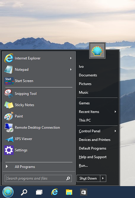

PostPosted: Thu May 23, 2019 4:59 am
Just remember, Classic Shell got it first - both the "Light skin" and the "Dark skin (Midnight) before MS got "inspired": :lol:
