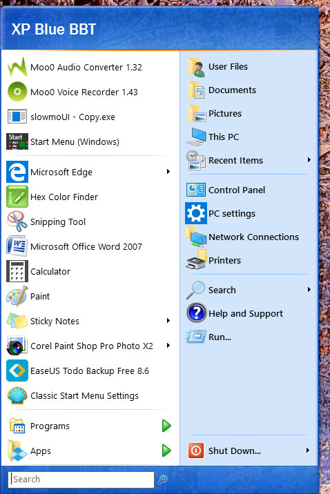

XP Blue BBT rev B (Classic 1 and 2)
The fat Blue Bottom Border is back, now with Transparency! (BBT)
Please be aware, it can not look and function same as original.
It is a compromise. Skinning can only do so much.
Tried with CSM 4.1.0 on Win7/8.
After downloading file, paste in skins folder. Usually C:\Program Files\Classic Shell\Skins
Exit CSM, restart CSM, and go to "Start Menu Style" tab.
Pick Classic or Classic two columns.
Pick "XP Blue BBT" in Skin tab.
If you want to have at least the power button on the blue bottom, click on the Extend right text.
It can not be white text, unless Ivo has some overide trick in CSM settings?
I find if I extend the left text, the search box fits nicely. One has to drag a separator
in the Customize Start Menu tab, and drop it just above "search box".
This will give a buffer space for item button above it.
ps This is only the blue XP. Green and silver not included. File size at 1.38MB already.
I cheated and put a screenshot of real XP menu in bitmaps.
The alternative variation was a blend of original, Classic Shell, and my own.
And as always, if I left some bugaboos, sorry. You can tweak the text and bitmaps,
and upload the improved menu to share. :)
I decided to include more bitmaps for Transparency. They are at 230/255 Alpha layer,
using fullalpha. If you want to use menu in Win 7 with fullglass blur,
one would need to edit the bitmaps to 200/255A or lower,
and change opacity text to "fullglass".
One more thing, if you want to live dangerously, and have icon buttons for shutdown sub items,
on the blue bottom border, fine. GauravK shows how to do it. For me, after accidentally
hitting the log off button, and losing my work, I pass.
The all knowing GauravK provides a solution for that:
"There is a "Confirm Logoff" option in the Start menu settings".
Note. The extended bottom paddings will not work in Hi-DPI.
RevB removed large green arrows on split buttons, added face variation.

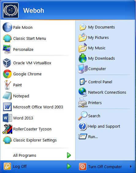

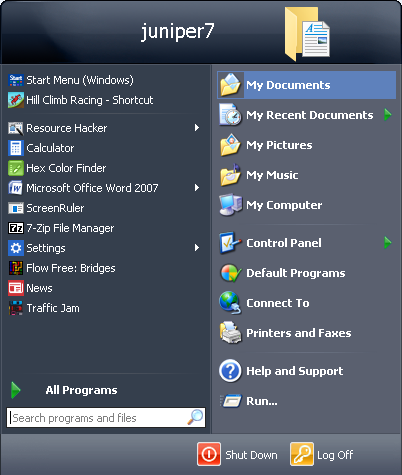

Here's mine. To get it like this, I had to extend the left and right borders, and add log off directly after programs. XP's All programs doesn't have an icon, so I typed "none" (without the quotes) to get it blank. And to get the buttons on the left to have the blank space on the bottom instead of the top, I had to add empty buttons below the rest of the things on the left. All that's missing is being able to add white text to the bottom, removing the arrows after log off and shut down--while still keeping the sub-menus--and separating the log off button from the left row, so that it can be more to the right, like it is on XP.

Hello Weboh.
That's funny. I thought I was helping you, and find out you did it already:)
First I thought-piece of cake. So easy, until I switched to small icons. All yucky spacing.
Took me a day just to sort that one out.
Yep, I messed around with a lot of things as well.
I made buffer/padding icon buttons, with bitmap picture inside of bottom border.
These were placed to be invisible, to push the log off, and power icon buttons to proper areas.
I even has the white lettering for "Turn Off Computer" right on the menu bitmap. The selection button,
with the exact invisible cutout lettering, to let it show through as white when selected.
But of course, as the menu shrank and expanded, it went way out of alignment.
These are not on uploaded menu. It had to be as simple as possible for others to use.
I wonder if an icon button has to be square? If not, the log off picture and text,
could be assembled as a rectangular icon button?
I just noticed both our menus have different separators from real XP.
Original is shorter and snubbed out. Yours looks better.
Anyway, that's about as far as I want to take it,
getting even closer requires a lot of head scratching.
I don't like the sight of blood.
The weekend is over, and it's time to go.
Bye Weboh, the XPerienced.

Nono, you totally helped me. :) This is just my configuration of your skin, that I posted for reference for everyone else.
Well, I wouldn't mind having it. I'm actually spending more time making Windows 7 look like XP than I did using XP. :P It's fun to me.
I assume it's different because I'm using it with a third-party Windows XP skin.
And sadly, Icons have to be square. I wish Classic Shell didn't require changing so many things into limited icons, but then again, at least we have it. Windows 7 (and especially 8) would be a nightmare without it.
Maybe GauravK or someone could try and fix some of the issues we noticed?
And if you need a project for next weekend, I'd appreciate it if you did this, or made the Silver version of this. :)

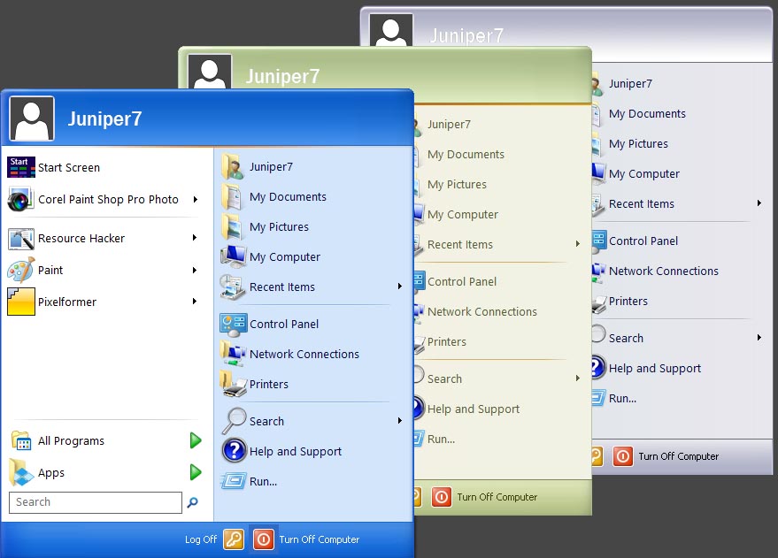

 Post subject: XP LunaBB revB
PostPosted: Sat Aug 02, 2014 4:49 pm

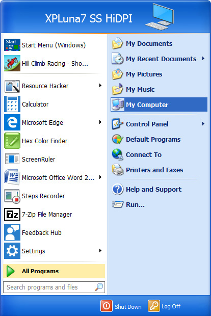

:!: Warning :!:
Don't download, unless you like to tweak CSM settings.
Will not look good, straight out of the file box.
Bottom text will be all jumbled and scrunched up.
Blue/Green/Silver.
This is another version, my last attempt. At one time the bottom lettering was clear type. This one looks like original XP chunky text.
There is no way to make like original. If I squint my eyes from 15 feet away, it kind of looks like old xp.
This is closest I can make, but as I said,
requires lots of manipulation in "customize start menu settings".
Check out picture for visual instructions.
If using small icons option for main menu, minimum menu spacing will need to be increased further,
so add more blank spaces in between the & and &.
At bottom, it is only the icon buttons that will be highlighted with mouse over, not the icon and text.
I added option to show top thick border without name or user picture, because, well,
blue is beautiful you know. Also the slices are different, so around two thirds of top border could be used for game logo,
or say the face of a blue girl staring at you. If you know how to use Resource Hacker, you will find a test bitmap of her.
She is really airbrush hood painting on a VW beetle. Credits to painter.
To be a simple menu, the selectors are only color referenced, so no fullalpha, fullglass transparency is available,
unless real 32 bit selector bitmaps are put in place.
ps Thanks GauravK, concerning the log off confirm option.
I assumed the log off box would be in commands. None. Gave up at that point. Using Win8.1
After reading your comment, did a menu search, there it is.
ps Weboh, I tricked myself. I'm thinking wow, that person is really good. The menu name is like mine too.
The only differences are the ends of the right separators.
I read your post later. Eyeya! It's the jpg compression distortion,
that made it look more like original XP. That was a good laugh. thanks :D

Almost perfect! You're amazing!
Does this sound like an interesting project for next weekend?
PostPosted: Mon Aug 04, 2014 5:24 pm
:lol: Me thinks that's more than a weekend. How about 20 years project!

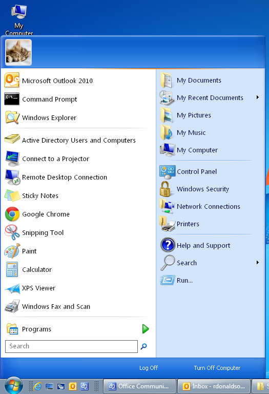

Hey guys, I'm new here on the forum :D.
I've only just discovered this XP skin, and it's awesome!! The only thing is, when I changed the skin and loaded the .xml settings, I don't get the log off and the turn off computer icons aren't showing - and I can't even click on anything.
I know it's been ages since you've been working on it, but maybe you guys could help.
Do I need to use a specific version of Classic Shell? I'm using CS version 4.2.1 on Windows 7 Enterprise.
Cheers :)

Hi rd1993.
well, that's a bummer.
I just retried on Windows 7 Ultimate, and it works, with 4.2.1
By the way, there is only a small square around where the icons would be, that is active.
The text is just dummy text, imbedded in the menu picture bitmap.
Nothing will happen, if clicking on text. :)
I don't have Enterprise version to test it.
The xml file, tells CSM to use the LogOffItem.Icon=%SystemRoot%\System32\shell32.dll, 325
and ShutdownBoxItem2.Icon=shell32.dll,329
Looks like you are going to have to manually find the icons, in a different .dll location in Enterprise, with "Customize Start Menu tab".
or download them to folder on drive, and instruct CSM to find them in that folder.
Sorry, I wish I could help further.

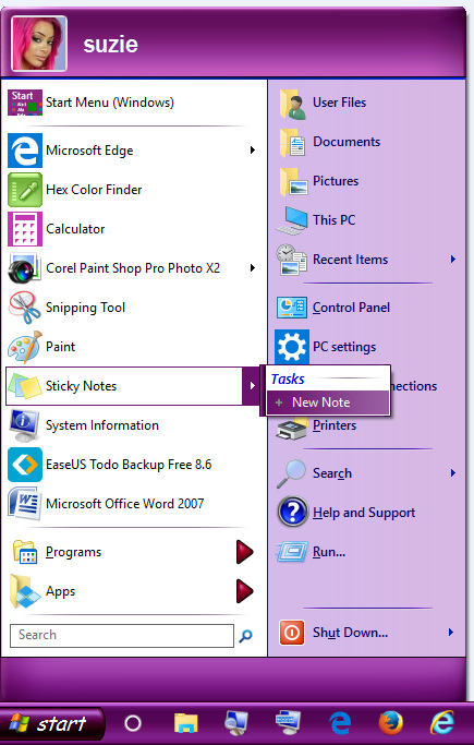

PostPosted: Mon Jun 06, 2016 6:30 pm
XP suzie (classic 1 and 2 column)
This is suzie copycat menu for CSM.
From way back in 2001. Someone changed the color of Luna XP to this rich purple.
Difficult searching on internet. I don't even know who made it, to give credit to.
I've had it forever. The only purple menu I could use longer than half an hour.

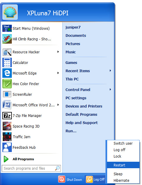

PostPosted: Wed Dec 07, 2016 5:50 pm
XPLuna7 HiDPI.skin7 [7 style] For CSM version 4.3.0
Making both columns roughly equal width, does cause a bit of a problem, when inside submenu tree is used.
Kind of narrow cramped! I would suggest to turn on "Large font" option.
The Tahoma font doesn't make taller text, but rather w i d e r spread out text. This makes column 1 wider.
If using flyout submenu, does not matter too much.
Can always increase the default value of "Programs pane width" in CSM settings.
Problem with that is, the user picture that is set for 1st column, floats around, not locked in position.
That part is an experiment. If it bothers you, switch to default right position.
Text looks sharper with Font smoothing off.
Now that All Programs arrow is so XP big, hard not to notice.
Why does the arrow point opposite way for inside menu?
Does not make sense to me.
It should point to left, or at a north-west angle to open tree,
and point to Back, for returning back to normal view.
Better not go against the flow, will leave as is. :)
Edit: Changed to revision B
Reason was, if menu at top taskbar position, user picture would drop inside menu.
Now it stays within it's vertical boundaries.
Still don't know how to separately trigger search bitmap to show bigger images for HiDPI.
So I maxed out the 16 pixel space with bigger XP magnifier.
XPLuna7 HiDPI revB.skin7 [357.5 KiB]
Downloaded 14571 times
PostPosted: Wed Dec 07, 2016 5:54 pm
XPLuna7 SS HiDPI.skin7 [7 style] For CSM version 4.3.0
It is the XPLuna7 HiDPI.skin7, with added fake icons added in second column.
The SS stands for ScreenShot. I had to make and paste many screenshots to get the images lined up.
Also, the icon pictures are stuck that way always. Can't rearrange.
I have to stress, this skin only works properly with the xml file loaded,
to assign the proper matching links, and separator positions. Otherwise, 2nd column will be a muddled mess!
You can still put your own language text in second column.
Just try and keep the same width of start menu, or the left user picture could disappear. ;)
If you absolutely want one or more shortcuts with fake icon below what's there already,
use the custom image option to add your own icon picture (size matters 24pixels/100%, 32/125%, 36/150%),
And set up your command/link in "Customize Start Menu" tab.
XPLuna7 SS HiDPI revB with matching xml.zip [267.75 KiB]
Downloaded 14252 times

PostPosted: Wed Dec 07, 2016 6:21 pm
Posts: 116
This is pretty cool. Good work making it Juniper, keep up the good work. =)
PostPosted: Wed Dec 07, 2016 10:58 pm
What can I say juniper7 except it's perfect and high quality and a lot of hard work!! :mrgreen: ;) :) :D :P :mrgreen:
The magnifying glass icon for search / (x) icon when we begin searching is smallish at high DPI. Everything else is perfect!!
Can you PM me your PayPal so I can show my appreciation by donating some amount?

Embedded7 Plus [7 style] Use with CSM 4.3.0
Embedded plus Zune plus Royale plus Noir plus HiDPI
Only HiDPI 150% I cut out the 125% size.
Gaurav had already made an impressive Classic 2 style, all in one skin.
This is the 7 Style version of the same skin.
Embedded7 Plus.skin7 [719.5 KiB]
Downloaded 15757 times

Embedded7 SS Plus [7 style] Use with CSM 4.3.0
Same type of skin with the additional icons image in second column.
To get it working, the xml file has to be loaded, to align the second column.
Same deal with the entries stuck that way. No rearranging. Can only add a couple extra at bottom.
Embedded7 SS Plus skin and xml setup file.zip [393.95 KiB]
Downloaded 12905 times

Thanks juniper7. Your skins are always polished and it's a challenge porting classic with two column skins to 7 style but you do a superb job. For sake of completeness, these are an excellent addition to the collection of skins we have here in the forum. :)
Enjoying it :P

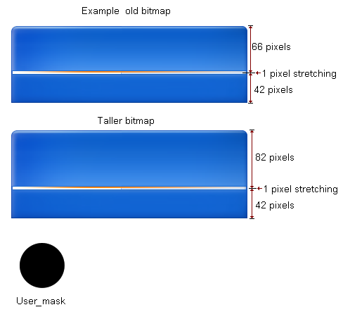

Can anyone help me with enlarging profile picture in this skin? EDIT: By "this skin" I mean XP Blue BBT from opening post.
I have changed
Code:
[USER_IMAGE]
User_image_size=48
User_frame_position=10,8
User_bitmap=13
User_image_offset=2,2
[USER_IMAGE OR USER_NAME]
Main_bitmap=2
Main_bitmap_slices_Y=66,1,42
Main_padding=7,71,7,45
Main2_padding=7,71,7,46
to
Code:
[USER_IMAGE]
User_image_size=64
User_bitmap=13
Main_bitmap=2
Main_bitmap_slices_Y=82,1,42
and replaced Bitmap6 and Bitmap13 with bigger ones, yet it doesn't work. No idea what to do next. I tried to change various padding values but it didn't help.

PostPosted: Sun Oct 15, 2017 3:19 pm
Have not looked at the revB file for awhile.
Variation 1 Original two column with picture has Main_bitmap=2
Variation 2 Flatter bottom two column with picture has Main_bitmap=6
Variation 3 Transparent top/bottom two column with picture has Main_bitmap=17
Variation 4 Transparent top/bottom with face two column with picture has Main_bitmap=28 with different dimension slices.
along with same user picture frame User_bitmap=13 for all variations. Its frame is 52 pixels high.
Ok, now trying to figure what I am seeing in your pictures.
For first picture, the main menu bitmap looks like variation 2 with flatter bottom.
The second picture, I might be wrong, looks like variation 3 altered transparent main menu bitmap.
The vertical slices don't look right. See my picture where the vertical slices should line up.
Your picture frame, black part show 64 pixel height.
It's ashame you put the red over the user picture. Does user picture show, and just hiding it?
Kind of looks like you want a round user picture?
If you just want a round frameless user picture, steal the 64 pixel bitmap 18 from Metro skin.7
and use this text instead.
User_mask=13
Can add a (frame) User_bitmap to be above with a different number.
If all I have said is too confusing, upload your modified skin and we can see if we can get it working the way you want. :)
