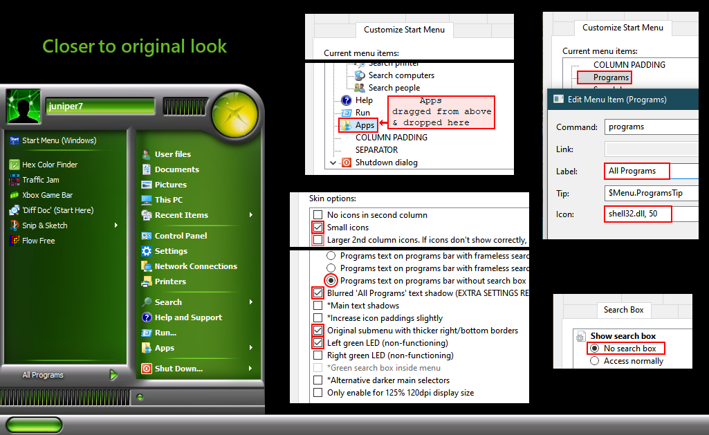

***THE EASY SOLUTION***
If you just want to try out the skin without all the extra settings,
just set the "Search box type and location and Programs bar options" to "White search box inside menu".
THIS IS THE ONLY OPTION THAT WORKS FOR USERS WITH IN-BETWEEN DISPLAY AND ICON SIZES.
For anyone with more time wanting to toy with the other search box, All Programs, bars texture locations,
I've added a display picture in the next post with the similar original look
with all the settings required in Skin options, and the general settings tabs.
For most of the other menu looks, the search box is usually enabled.
Any option that has programs text on the grey programs bar has to use small icons on the left column.
The other options can use small or large icons on the left column.

PostPosted: Wed Dec 15, 2021 1:59 pm
Well, this might be the last skin I port or make. I recall saying that many times before. :lol:
Happy Holidays to all.
See ya!
