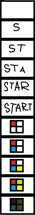

Well, I've losed. I was making a Animated Start Button.
Normal: blank
Hot:
S
ST
STA
STAR
START
(Windows Logo appears with no colors)
(Red on logo appears)
(Blue on logo appears)
(Yellow on logo appears)
(Green on logo appears)
Pressed: Colored Windows Logo but the logo is dark.
There is a preview (Attachement only cuz the images is put on my dA but it's banned)
PostPosted: Sat Dec 06, 2014 10:37 am
Looks like your image is treated as a simple 3-state button. Most likely you are missing the first row of pixels that describes the animation sequence.
PostPosted: Wed Dec 10, 2014 1:52 am
Joined: Sun Nov 16, 2014 6:21 am
Posts: 20
Yep. Can you help me then or make me a start button for me? Did not understand in the forum or in the animation page.

I have the version of your start button that works correctly, I got a start button that was supposed to work like that and I copyed the first row of pixels.
I have the 2 photos, if you need to make a start button like that ag
ain, paste the Anitop on top of the start button. :D :D :D :D :D :D :D :D

Sorry, I forgot to put in the photos, here they are.
PostPosted: Sun Sep 13, 2015 9:46 am
Joined: Sun Sep 13, 2015 9:38 am
Posts: 6
Anitop:
File comment: Anitop
Anitop.png [ 208 Bytes | Viewed 65737 times ]
File comment: Your start button

In mspaint, resize anitop to 14x1
