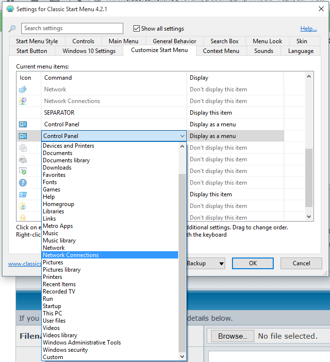

I am using Classic Shell 4.2.1.
I do not see an option for "PC Settings". Not in the Customize Start Menu tab, nor in the list of commands that may be added to that list.
Am I looking in the wrong place?
PostPosted: Fri Aug 07, 2015 11:12 am
@bblackmoor You haven't upgraded to Classic Shell 4.2.3 or later.

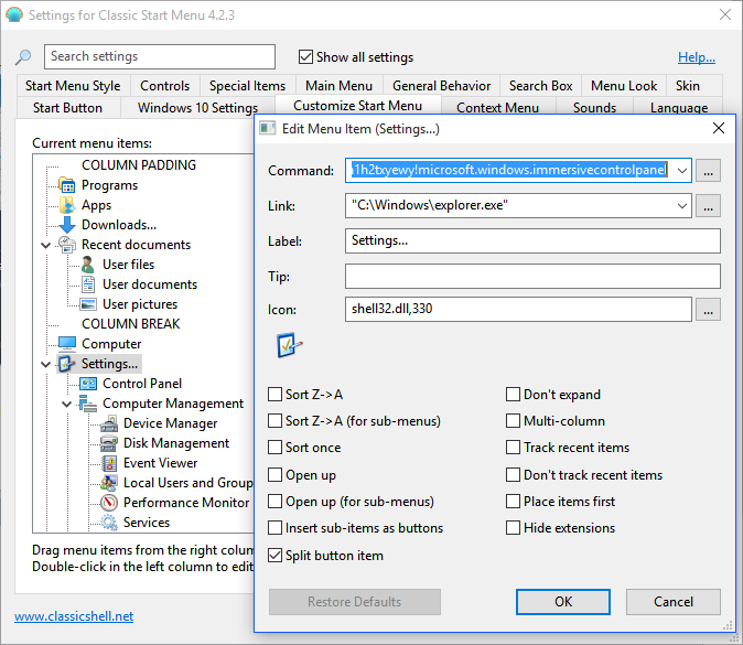

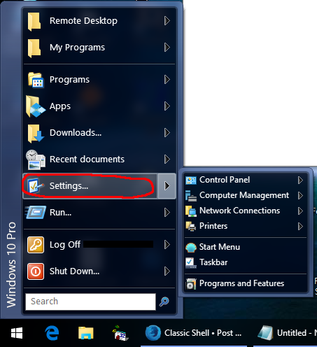

A month ago, I figured out how to make the Settings app open when clicking the "Settings" menu item (circled in red in the image below). Now the Classic Start Menu's Settings button cascades to provide the Control Panel, Computer Management, Network Connections and Printers options, while being itself a hot shortcut that opens the Settings app when clicked:
Just today, I learned about the new PC Settings action in Classic Shell and gave it a try. Unfortunately, the new Settings button stops working as soon as a sub-item is added, even with the "Split button item" option enabled. I am hoping this can be fixed in a future version. In the meantime, to make a menu item that opens the Settings app while containing sub-items itself, make the following changes in the desired menu item's properties:
Command: shell:AppsFolder\windows.immersivecontrolpanel_cw5n1h2txyewy!microsoft.windows.immersivecontrolpanel
Link: "C:\Windows\Explorer.exe"
Split button item: Enabled

Thanks for reporting the bug about PC Settings not working if it has a sub-menu. It will be fixed in the upcoming version 4.2.4.

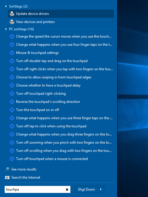

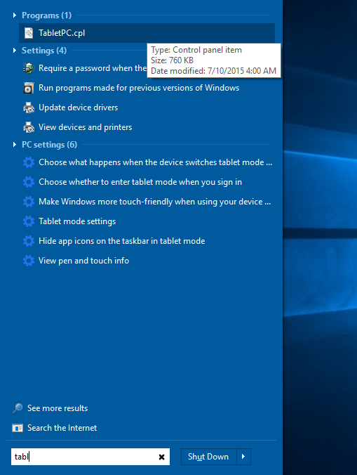

I would have expected for this "PC settings" and it's submenus/categories to show up in the settings section of the searchbox results just like the old style settings, but it didn't. It only shows up (and only PC settings, nothing that's inside it) when I enable show metro apps and in the app section.
Will PC settings stuff be added to the searchbox?
PostPosted: Tue Aug 11, 2015 3:43 am
The Start Menu already searches the PC Settings.

PostPosted: Tue Aug 11, 2015 4:56 am
Right click start button>Classic Shell Settings
Type 'pc' into the search box
the only setting available should be the one you need
(alternatively its in the "Search Box" tab, when show all settings is checked)
PostPosted: Tue Aug 11, 2015 4:58 am
If PC Settings are not being searched for you at all, try this:
1. In Classic Start Menu settings, go to the "Search box" tab. Make sure the "Search PC settings" option is checked.
2. In Control Panel -> Indexing Options -> Advanced -> go to the file type, settingcontent-ms. Try changing the default from "Index properties and file contents" to "Index properties only".
The index will be rebuilt. That will take time depending on how many files and folders you have added to the index. After it is rebuilt, you should be able to search PC Settings too.
