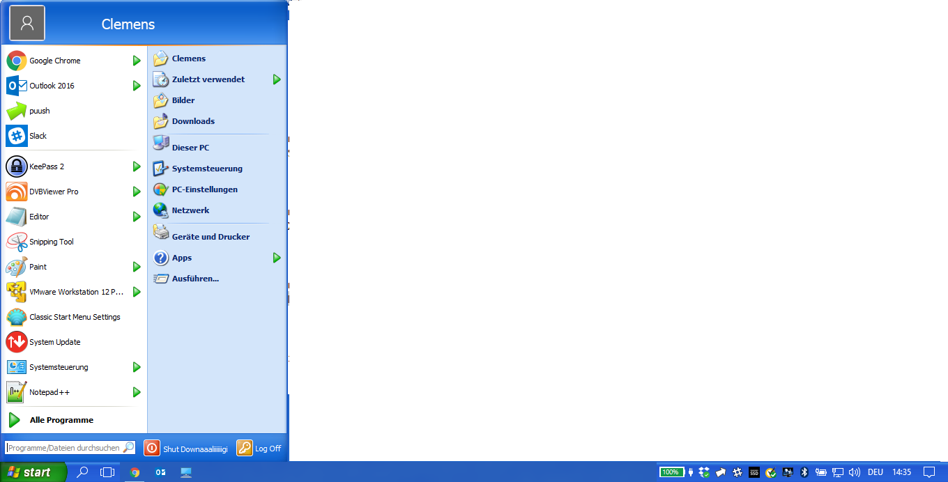

Hello,
I'm trying some xp / vista skins, when there is text for the shut down button some weird characters are added (this happens in all skins I tested so far).
Anyone an idea where those come from and how I fix this?
OS is Win10 Creators Update
Kind regards,
Clemens
EDIT it also happens now at the default skins, very strange, normally (on my other pcs also if I remember correctly) there is the german "herunterfahren", but something has overwritten this...
EDIT2 changing language has no effect on that button

PostPosted: Thu Aug 10, 2017 2:23 pm
This reminds of something before.
Looks like modified file from OneSerendipity StartMenuL10N.ini
got into the mix at some point.
viewtopic.php?f=17&t=7516
PostPosted: Thu Aug 10, 2017 11:59 pm
Yeah editing C:\Program Files\Classic Shell\StartMenuL10N.iniStartMenuL10N.ini or uninstalling and reinstalling Classic Shell should fix your issue.

Thank you, editing that file did the job
Other question: what is the meaning of the "&" in that file?
Most of the time it's at the beginning but in the linked thread it isn't.
Thanks!
And yeah indeed I tried a vista skin before with some weird hidden font.
PostPosted: Fri Aug 11, 2017 2:13 am
The character after '&' will be underlined in the menu and used as the keyboard accelerator shortcut.
