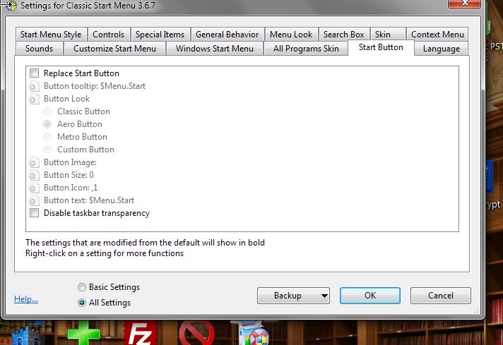

Ok I see what you say, however my Start Button tab does not have an "Enable Start Button" selection. I have attached a pic of my
start menu tab.
File comment: Pic of my Start Button tab

Hm, that's weird. Looks like the start menu thinks you are running on Windows 7. I thought you said you use Windows 8.

Oh my gosh. You are right. I installed in in my computer , which runs Windows 7 Pro. Then I installed it on a friends laptop
which is running Windows 8. It is on the laptop that I am having the problem. I guess until I can access their computer again
I will not know about the "Enable Start Button" box. I am sure it is like you say. Hopefully this will clear up the problem and I
can assign whatever key they like to bring up the Start Menu Button. Hopefully down the road someone will come up with a
solution to have the Classic Start Menu Button and the Desk 365 icon both on the taskbar.
Thank you very much for a speedy and courteous solution to the problem I had.
