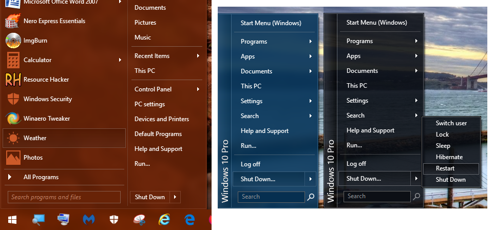

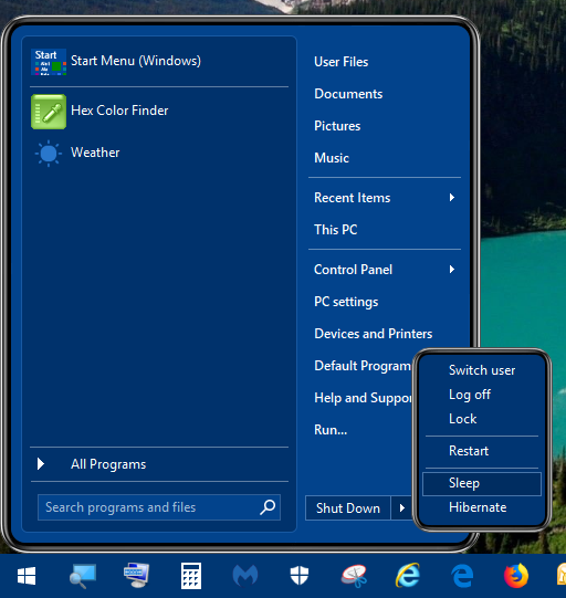

PostPosted: Sun Jan 13, 2019 12:10 pm
Another one for the road.
It's just a dark opaque 7 style skin.7
Even though I never figured out a transparent search box,
what bugs me more is the search box flashes for a brief instant.
What I now see happens, is part of the inside of dark-colored search box will show the desktop behind the menu,
( like when using a 24-bit selector bitmap instead of 32-bit on a transparent menu).
Problem is, it's an opaque menu with alpha opacity.
I can duplicate effect almost every time by hovering over submenu entries, then click on the search box.
If I switch to region opacity the flashing goes away, but due to the round menu corners,
extra artifacts there don't look so hot, so it has to be alpha opacity on this menu.
Big round corner grey menu with dark search box.png [ 197.95 KiB | Viewed 115694 times ]

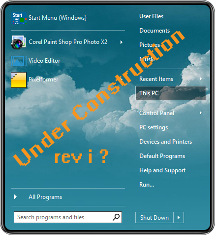

As Classic Shell site is still up and sometimes there are over 400 guests, ( campers?)
I'm in process of gutting much of rev H and making a simpler custom image menu.
See under construction picture below. I'm thinking of putting a bunch of abstract images inside the skin,
like meetHG has done.
Let's see If I can beat the shutdown.
Update:
I'm still working on it after encountering some snafus.
Some are bugs that can't be fixed. Others are my mistakes.
Another one to two days to add everything. Picture menus tend to be big files.
I'm expecting around 3 meg download size by the time I finish.
I'll place it in the Start Menu Skins section
