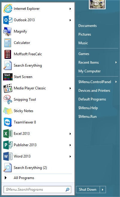

How do I remove the "SMenu." in front of the menus and the search Windows? When I click on the start button it says SMenu.Run, SMenu.Help, and SMenu.Control Panel. All the rest of the menus are normal.
 Post subject: Re: SMenu. Removal
PostPosted: Thu Oct 24, 2013 12:09 am
Looks like your C:\Program Files\Classic Shell\StartMenuL10N.ini file got corrupted or damaged. A repair install of Classic Shell should fix it. All your settings will be preserved.
