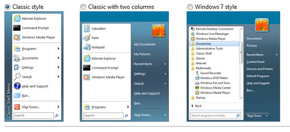

Using Win 7 Professional SP1
I can select the classic style with 1 column in the settings and the start menu will change to the single column but next time i start my computer the start menu is the classic with two columns, when i go into settings the Classic style 1 column is still selected and without doing anything the start menu will then be back to the Classic style 1 column. Any reason why this would be happening ?

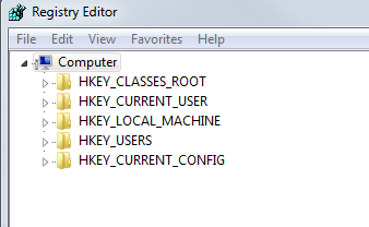

I am not sure where you find the HKCU key, I have attached the regedit folders.
PostPosted: Fri Apr 18, 2014 9:27 am
HKCU is abbreviation for HKEY_CURRENT_USER. Don't do anything unless the problem reappears.
