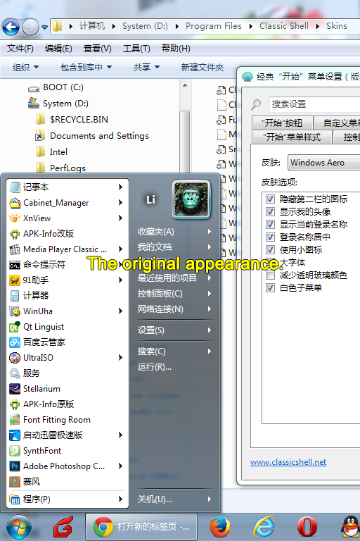

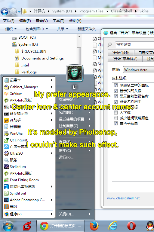

I would like to use Classic Start Menu with "Two-column classic style" on Win7, but I don't like the user icon position with this style, I like to set the icon to the center as "Windows 7 style".
Can Classic Start Menu change user icon position? I cannot find such option in Classic Start Menu's setting page.

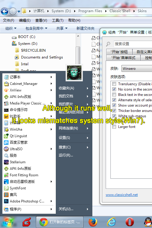

Thanks,your skin runs well, but I feel it mismatches win7 aero style.
Could Classic Start Menu add such style skin in next version?
