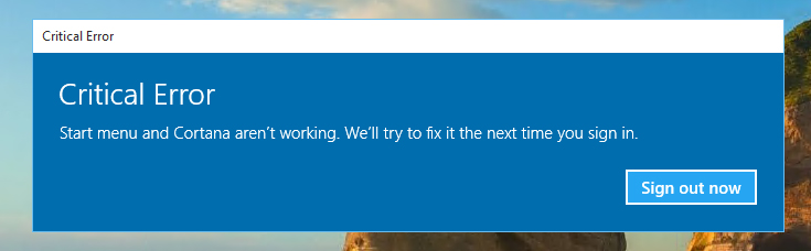

Well it looks like it may not be classic shell. I've removed classic shell and restarted the PC, and now I'm getting "start menu" rather than "classic shell"..... perhaps its a tsplus issue then. haha oh what fun...
PostPosted: Sun Oct 18, 2015 6:55 pm
Are you certain the old message did say "Classic Shell" and not "Start menu"? Busted start menu is a common problem with Windows 10 and I am not aware of a fix. I just know it is not related to Classic Shell.
