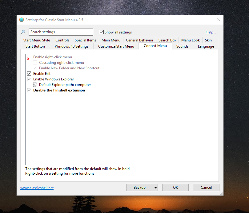

Hey guys, just wondering if anyone knows how to fix this problem, I've always been able to right click on the icons in the start menu, but today i realized that i couldn't do that anymore and i looked into it, and for some reason this
option isn't clickable anymore, does anyone know what the solution to allow me to click this option again?

PostPosted: Tue Mar 29, 2016 1:05 am
Check if that PC has a Group Policy setting configured "Enable right click menu". Set it to Not configured. Or check if a Registry DWORD value called EnableContextMenu is at the Registry key HKEY_LOCAL_MACHINE\SOFTWARE\IvoSoft\ClassicStartMenu. Delete the DWORD value or set it to 1 to enable it. Then log out of your user account and log in again.

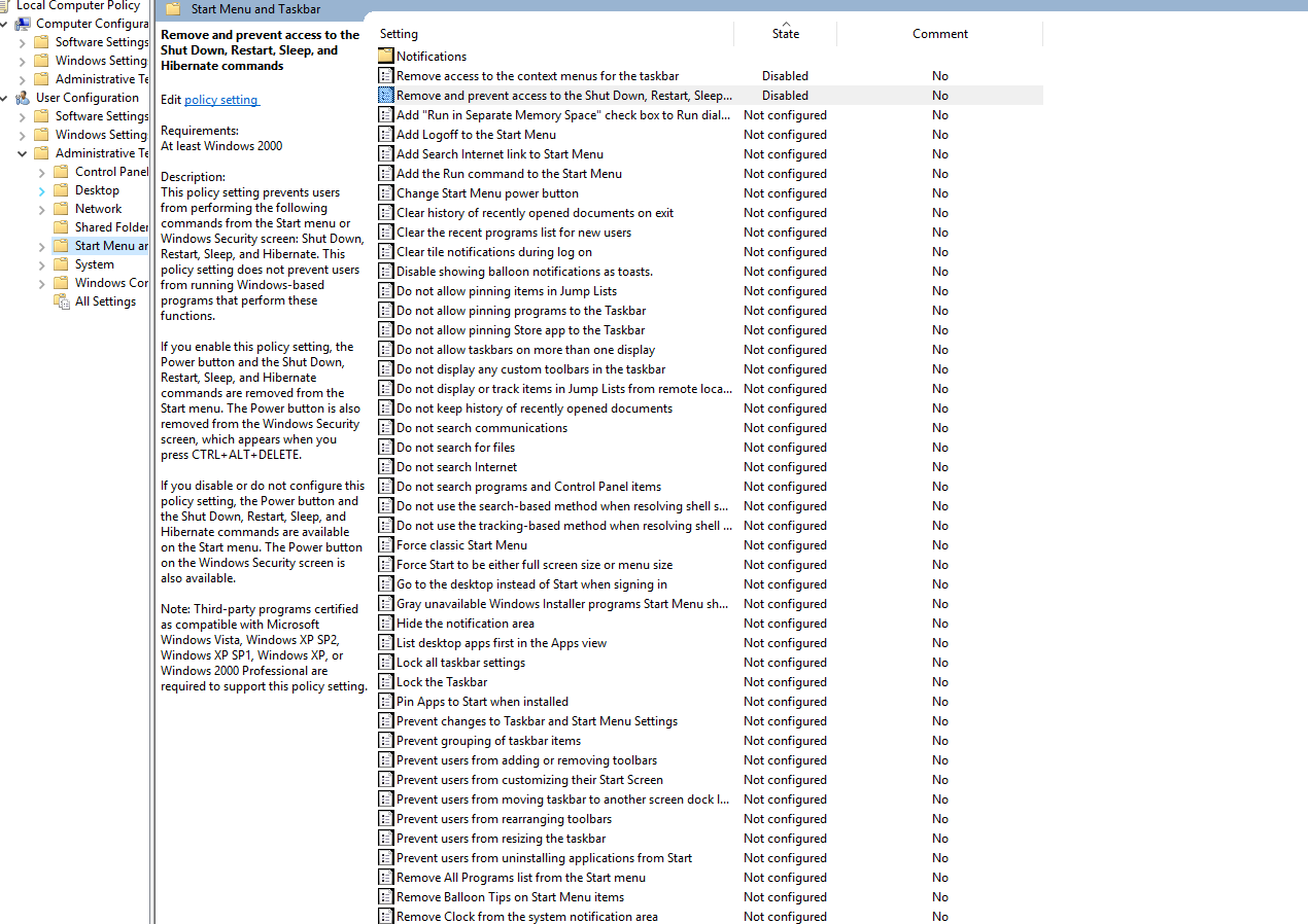

as you can see in the picture provided i went through all the policies in the start menu and taskbar folder and there is no group policy called Remove drag-and-drop and context menus on the Start Menu, so maybe it could be invisible? i have no idea what to do.

PostPosted: Fri Apr 01, 2016 1:39 pm
First, sort them alphabetically to make sure you are not missing something.
Second, there are similar policies in the Computer Configuration section at the top. Possibly the policy is set for the computer, not for the user.

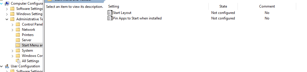

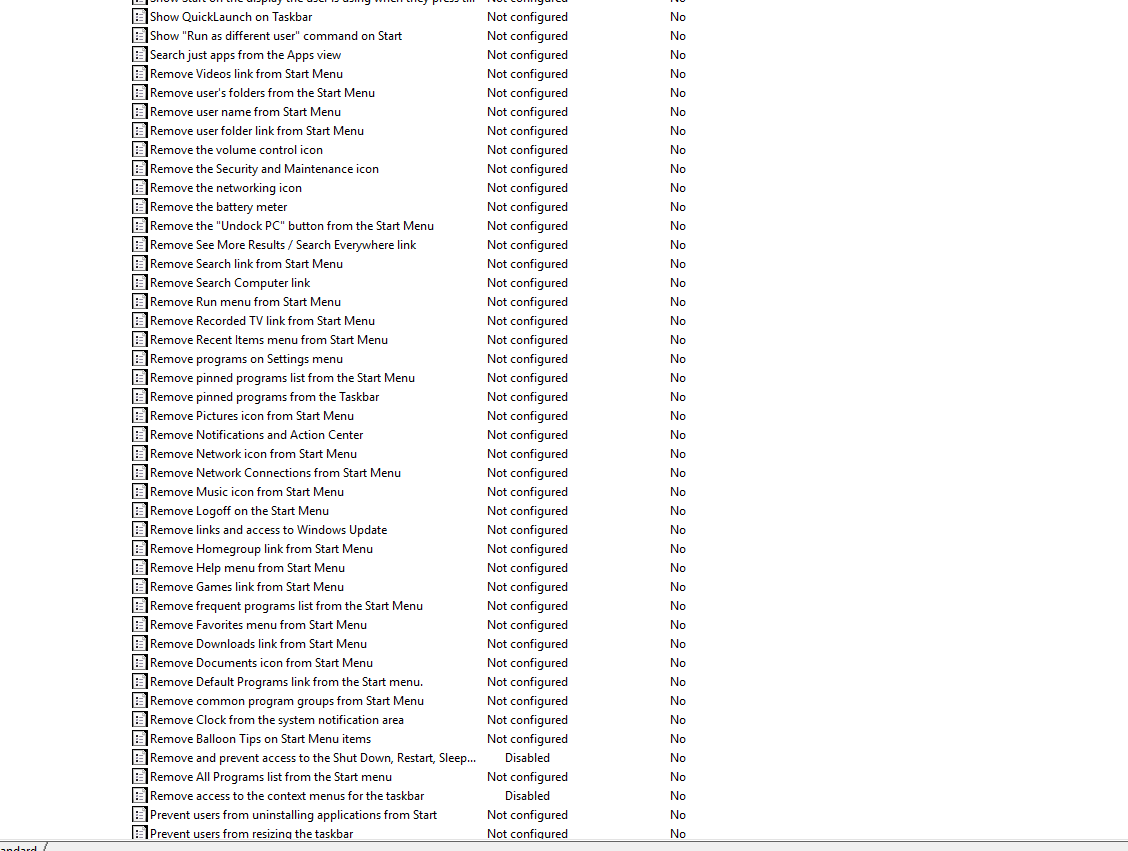

Joined: Mon Mar 28, 2016 11:30 pm
u sorted them and this is what i found
and the first picture is the one in computer configuration, so i dont know where else to look to fix the problem

PostPosted: Fri Apr 01, 2016 5:41 pm
Maybe this was in-place upgrade from an earlier versions of Windows, which had that setting? And now it is stuck in the "enabled" state with no way to reset it.
