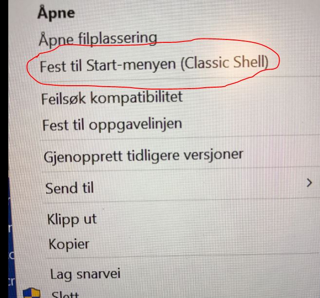

Hi!
Dos anyone now how or if you can remove the option : Add to StartMenu from the right click contextmenu ?
(I use policy's)

Open Classic Start Menu Settings and in the search box at the top of the Settings window, type: pin. Check the option to Disable the Pin shell extension.
